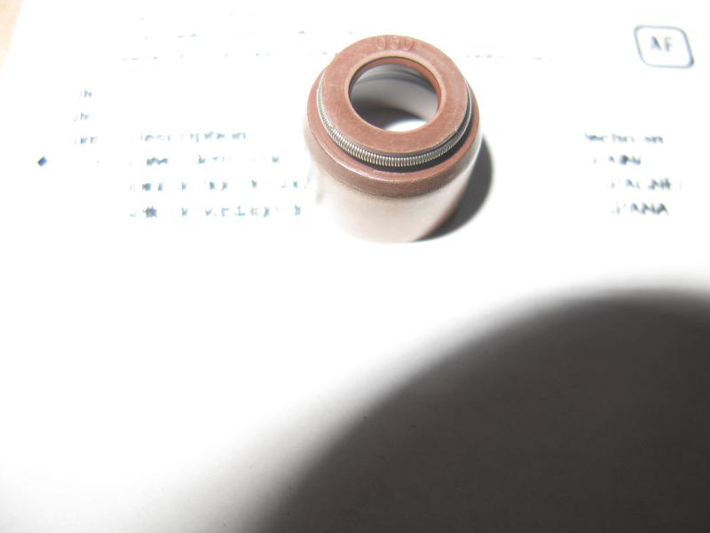

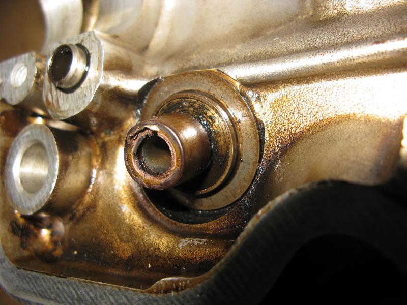

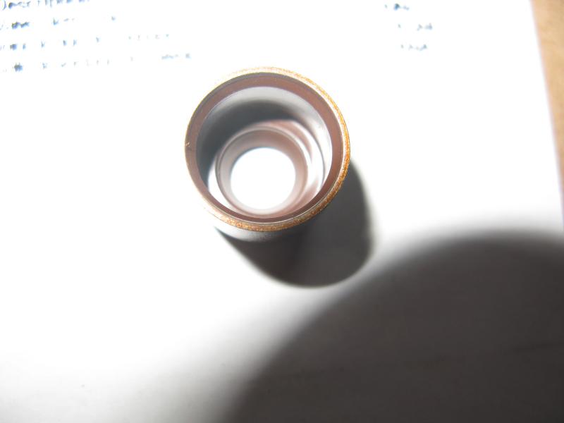

    The 1st pic is the stuck on kind of broken one, the 2nd & 3rd pics are of the brand new one.
    Do I really need to go buy yet another tool, and this one not easy to find so far, or can I just pry on it to get it off? Not sure what's under it, so asking for help please!!!
    Thank you!

    I used channel locks, and grabbed it, and pulled it right off. There is a o ring or groove or something you have to get ast (off now, then be AWARE of when reinstalling the new seal!
    I think I have a thread on here somewhere re my revalve seal and its wondrous oil consumption stoppage!

    Those seals are just pressed on using your hand and pulled off like thillskier mentioned. Simple thing to do once you have done it once, lol. Just grab a hold of it and spin and pull, Try not to damage the pedestal it is pushed onto. When you install the new ones, Fill with grease (pre-run lube) inside it so the valve stem has lubrication until the oil catches up and applies itself in those areas. Prior to restarting your truck after the work your doing, also pre-fill your oil filter with oil. Wait for all the bubbles to stop as you fill it full. Be sure to lay a rag under it as you replace it back onto its home because it will drip as you panic trying to find the threads, lol. This will assure the filter from having to be prefilled by the engine pump and possibly damaging things not lucky enough to get lubricated at startup.
    While you have valves out, thought about re-lapping the valves? This is also a very simple, but rewarding job. The lap compound is cheap and the tools is even cheaper. Tool is a wood dowel with a suction cup on both sides to suck onto the valve as it sits in the seat, apply a little compound and spin the tools like making clay worms in school. This will help seal the valve giving a better air tight seal with the head.

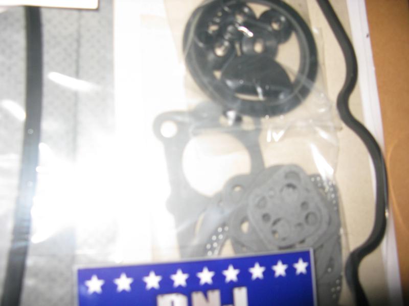

    Okay so I'm a super-level idiot now... I just opened the box that was the headgasket box, since I think I figured out how to clean the head gasket surface on the engine block and getting close to finishing up ... and IN the box was way more than just a head gasket.

    Holy crap, there's like every gasket and oring thingie in there and (drum roll.....) more NEW VALVE STEM SEALS!!!
    I was waiting on the valve stem seals that everyone was out in close by stores last night, to pick them up today & finish putting the camshaft parts back together today.
    BUT NOW!! Now I've got to figure out what all these o-rings and gaskets and stuff in the package is for! Other than the obvious to even me, which is the head gasket itself, the valve cover gasket, and the valve stem seals I'm oh so happy to see.
    This box has like EVERYTHING in it! Not sure what all I bought but this is going to be fun!!! Just found a product link for it: http://www.autopartswarehouse.com/sk...DNJHGS101.html (gosh hope that's ok for me to put here in the forum, if it's not sorry, I'll have to re-read rules & such) but that's what I got. I swear I only asked for a head gasket & the parts guy said oh we have a head gasket kit & I said OK.
    I just didn't open the box before since I didn't want anything bad to happen to the head gasket & figured it was safe in there until I was ready to use it.
    Oh and, it'll probably take me a few more days now that I have all this other stuff. It doesn't say waht all the things are for, even in the product link so yeah, a few more days for me.

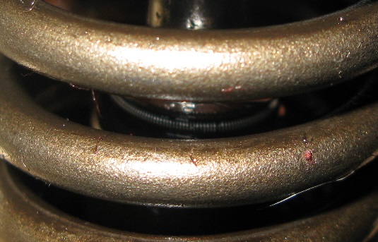

    Okay still being a noob, I just inspected all the little springs that go around the valve stem seals that I just put on, and almost all of them are damaged, like not a LOT, but I can see that they're not perfect... SO I'm going to have to do them again. Searching images & videos for how on earth people did them without damaging those little springs at all. I'd really very much like for them to remain absolutely perfect after the valve stem seal has seated gosh darn it, this is h-a-r-d.

    Pic, see that spring around the top of the valve stem seal? OMG I am going to have to pull ALL the springs again & triple check & stuff, ugh!

    Can you take a tool and manipulate the spring into position thru the spring. looks like it just jumped off its groove. Nice macro shot also.
    Don't feel too bad, some folks have to re-pull engines because they didn't install the rear main seals correctly and they leak all over the driveways.

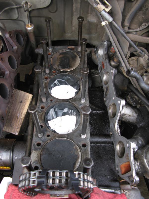

    Ok Thank you! I'm cleaning off all the old stuff today from the mating surface on the top of the engine block... NOT FUN! Actually said aloud "this sucks!" and then wondered if my neighbor heard me Must finish cleaning the old stuff off under the hood today because it's going to rain starting tomorrow. The head is safe in my house though so no rush... sort of.
    Hm, I don't have a wire wheel and wouldn't trust myself with one for this first time ever head gasket job. I'm using a lot of mineral spirit since I didn't have brake cleaner, and paper towels, rags, and that no-scratch scotch brite on a piece of flat wood because I don't trust myself to stay flat. Being super careful and taking my time especially around the coolant holes trying to not let anything fall in there.
    Oh and for the holes where the pistons are down I stuffed loads of paper towels & then taped around the top with electrical tape to hold the paper towels down & hopefully keep a lot of stuff from falling in & what does fall in hopefully will want to stick to the tape. I've been using round wood tooth picks (darn it wish I had plastic ones!) to pling out any little bits of gunk that try to fall between the piston walls & the top edge of the pistons as I go along. You know "PLING!!!" the bit flies out & lands randomly elsewhere.
    Oh yeah, and I cleaned the end threads on the OLD head bolts & turned them into the holes like 2 1/2 turns each to keep gasket bits from falling in to the threads... hopefully that will help make those easier to clean out. IDK, trying to think of everything though.

    Wish they made super big dixie cups to turn upside down & fit tight over the piston/piston holes!
