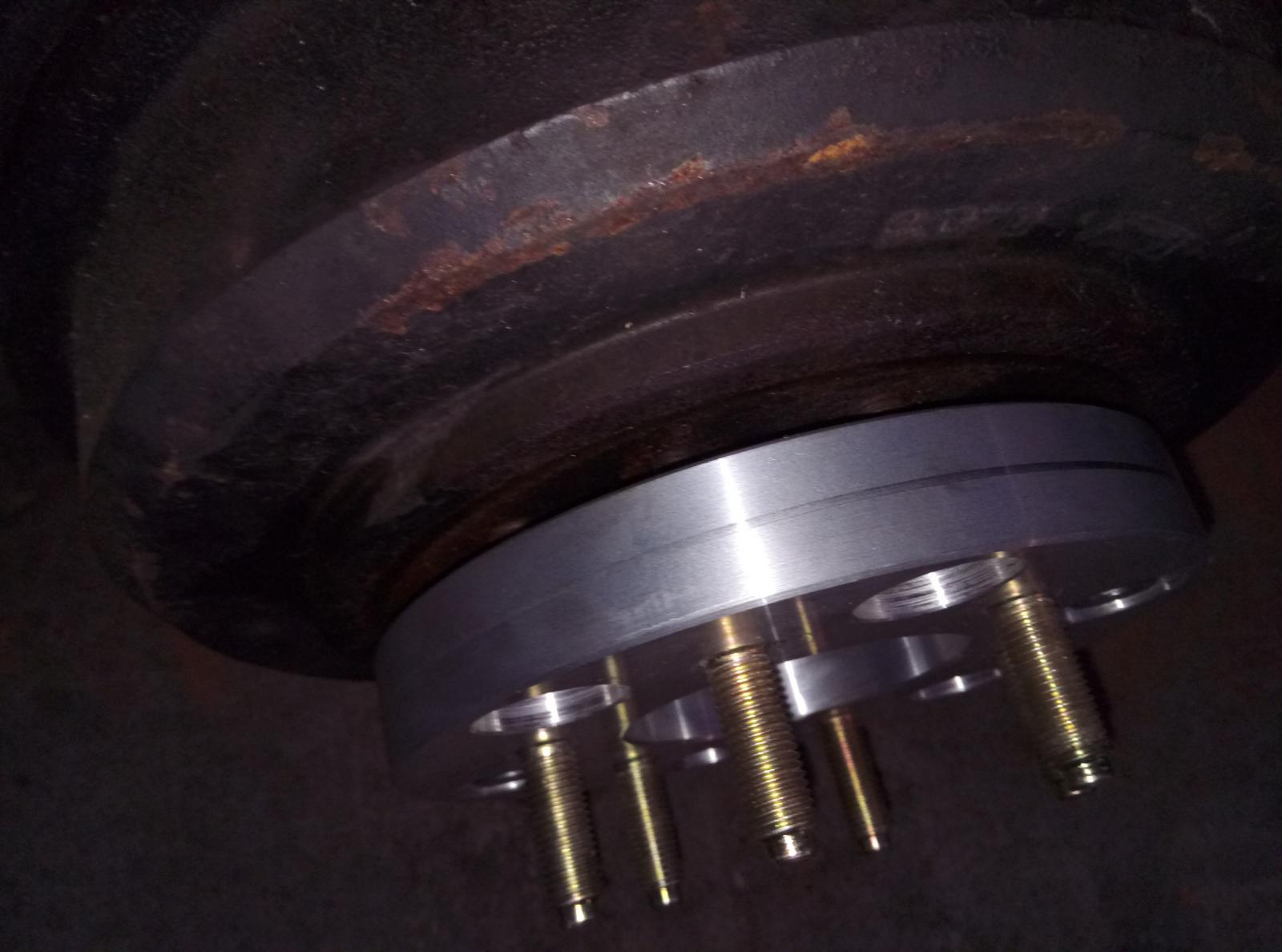

Is that how your hub adapters are mounted? They really need to be sitting flush with the face of the brakes to take the stress off the bolts. Amazing what a shot of paint can do
Associates Degree
No was test fitting the adapters, looks like I need a spacer to fit over the hub center. Will be installing the wheels next week. Can't wait
