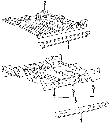

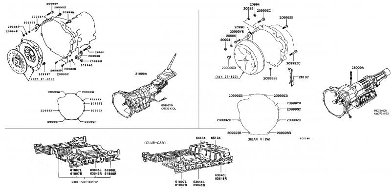

    When I got a doner truck, '87 with an automatic, I never notice the hump any larger then normal and I had to remove the trany and engine. Shipped the trany to Texas and truthfully the part that seemed larger then the manual was below the top half of the trany. Yes it was larger and that is a fact, but it all connected up to a wideblock engine just like a manual trany do also. I find it hard to think they put 2 floor pans in trucks, one for Auto and one for manual. Though they did create a block that was 1 inch wider, so who knows on that. Wonder if the humps were wider only and not deeper into the truck cab area.
    The bellhousing diagrams are not compared in size in this illustration. The proportion of the auto trany was shown larger in the ASA program and that's why it appears larger in the image. They are both the same size for mounting to engine blocks. From that point back, the size is unknown in compared to the manual.
    Here they are in correct proportion. Found additional floor pans styles for possible comparing.
    The 1st gen trucks definitely have different tunnels for manual vs auto - when I changed out Geronimo's cab for a cab from an auto truck, I had to bend the gas pedal to the left, and shift the clutch and brake pedals over so I could get to the gas pedal. I am still not happy with that setup, so I am going to mod the tunnel so I can put the pedal back where it belongs. If you have the 2 gas pedals side by side, one goes to the left of the pivot(auto) and the other goes to the right (manual), a difference of 2 inches. If the 2nd gen are different, I am not sure, but knowing mitsu, they don't change much over the years in the body department.

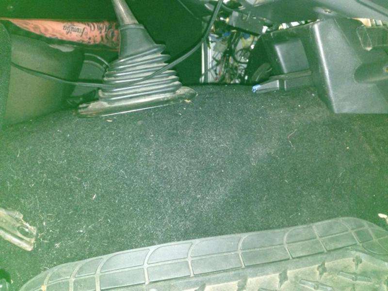

    A guy on Facebook said he measured the tunnel on his automatic truck (which he converted to manual) and said it was 13" at its widest point by the shifter and 7" tall at its tallest point.
    how does it compare to yours?
