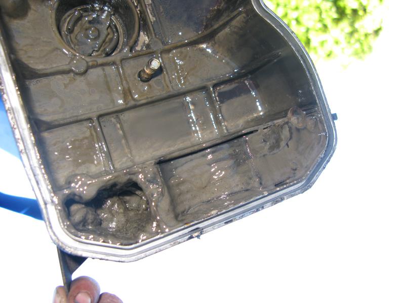

    The middle pic below shows the grey sludgey oil.
    That was the ONLY spot that I've found with it other than the oil cap rubber o-ring gasket thingie itself.
    I'm "thinking" I caught it just in time or just as it was starting happening since when I drove it to the store today it sounded & ran GREAT. I pull that cap off multiple times a week in all seriousness since it's still 'new' to me. But who knows?! I've got LOADS to learn.

    Found more oil gunk while I was cleaning the valve cover Went to the parts store and got what I hope are all the things I'll need to finish replacing the head gasket & valve cover gasket.

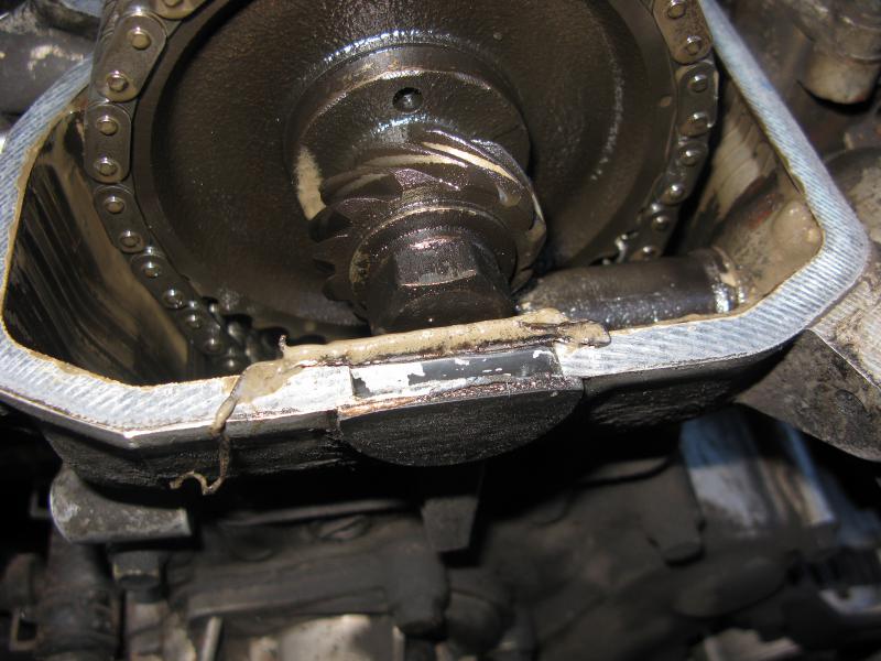

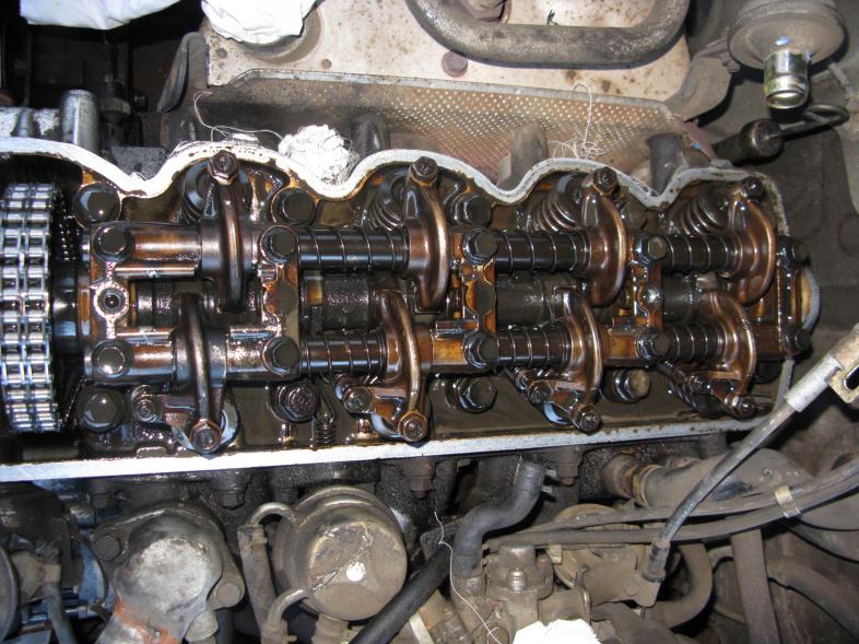

    Hey thanks Avatar was fastest yeah. okay so... you found me out, I have a female voice and get taken advantage of, rofl. So so frustrating. Yeah so anyways the muck thank thank thankfully is not all over the engine innerds, I am SO thankful for that I can't even explain, yeah. Just the inside of the valve cover and the cap so far ... though I haven't drained the oil yet not knowing how long the head gasket process will take me. Didn't want the workings all exposed any more than absolutely necessary. And now figuring I'll have to do an oil change like every 100 miles for a few weeks just in case. j/k but will keep a super close eye on it.

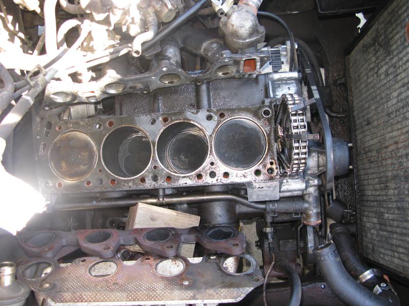

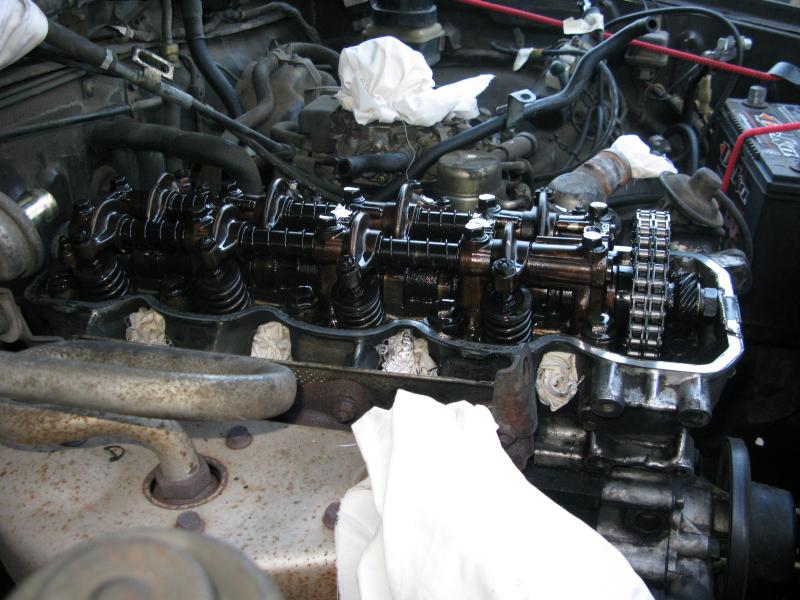

    The head is still on the rest of the engine because I got stuck on the 'last' step. I took out the camshaft bolt at the end, and off that drive bolt thing that attaches to the front of the cam sprocket at the very front in front of the sprocket but I'm not sure how to take off the head while leaving the timing chain on the sprocket and the sprocket nice and stationary in place. I saw on 2 different videos where people used zip ties to lock the chain around the sprocket, so I did that, and I stuffed rags down around the timing chain but I can't figure out what's supposed to happen to separate the timing chain sprocket from the cam shaft where the gold & the black pieces meet.
    Like at the moment that the cam shaft is pulled apart or up from the timing chain sprocket is the timing chain sprocket going to fall? Am I supposed to tilt it ever so gently forward off the cam shaft? Is the timing chain stiff enough to hold the sprocket upright while it's ziptied tightly around it & not get slack in the timing chain that makes the chain fall off the sprockets down in the crankshaft area? So many questions I don't understand yet how it's supposed to happen the right way.
    I saw people suggest to suspend the sprocket from some point under the hood but how in the heck do you take off the head if the sprocket is attached to the hood rofl. Ugh, I can't find a video that shows the order to do the last step in! Darn youtubers only have 2 hands lol.
    1:44 it's all zip tied up and 1:55 the head is off. WTF? http://www.youtube.com/watch?v=d3HSy...ature=youtu.be
    There's another video that shows the same darn thing. It's zip tied, and then the head is off. Only in that video the sprocket's not suspended from the hood. WHAT?! How on earth are these guys doing this... once again at 2:32 http://www.youtube.com/watch?v=dFgNp7052MU
    omg so... it's after midnight again and I'm reading and watching more and more to see the missing step somewhere. The book is zero help on this too.
    Yes I will go over that head with a magnifying glass all over and under and in everywhere possible looking for cracks! I will spend at least a day and night cleaning it and inspecting it. I'm obsessive like that. Really don't like doing the same job twice! I already found evidence that somebody had pryed/pried off the valve cover gasket in the past. It's not "too" bad but it's obvious. So frustrating. And for goodness sakes that's not even hard at ALL to take off. So not sure what to expect with the mating surfaces of the bottom of the head/block. But I won't pry.

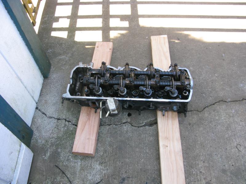

    Happy day, the head is o-f-f! The only trick is to go slow, lol. Nearly lost 3 fingers trying to keep that timing chain sprocket on the little metal lip, but managed to do it. Thank goodness I had a guy to help me by lifting the head off while I held on to that sprocket and the metal lip for dear life. Lots of pics to upload later because it looks like I've got an awful lot of cleaning to do! No idea what cleaners to use, etc. Steel, alumimum brass brushes or whatever but seriously Exhaling with relief now! It was so easy I think I can even get it back together after it's all clean

    That grey sludge might be from years of motor oil made from Pennsylvania crude. Back in the day a bottle of Quaker State would always have a bit of grey sludge at the bottom. I think they filter it out now.
    4,304
    Or its because quaker state is no longer made from PA crude oil. PA crude is the best oil for a lubricant because of its high pariffin content, but is not so good for making fuel out of. Once Pennzoil bought them out then Pennzoil got bought out by Shell, they were all moved to Texas and use other oils for their base oil.
    2,367
    Pennzoil was always good about making the inside of an engine all black. Turned from Pennzoil and never went back. Changed to Castrol (not saying it's the best, but it keeps engine internal parts from getting blackened.)

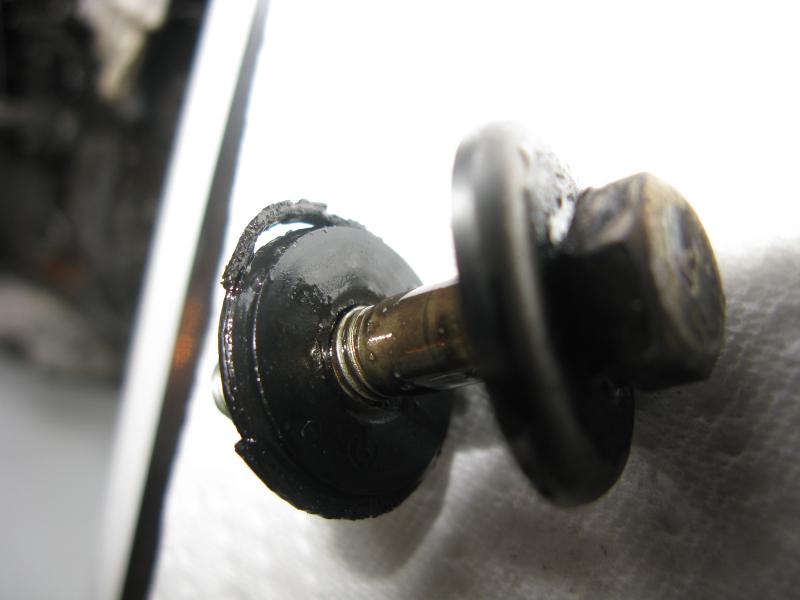

    Hm, I wonder how much this issue had to do with the oil not being happy:
    That right there is super hard rubber falling off around the valve cover bolt washer... Just found it. Maybe ya'll should peek at yours too?
    Never would have thought to look there myself since I didn't even know there was rubber down in that valve cover bolt hole, but I'm in the final cleaning stages waiting for the wind/rain to stop long enough to put the head back on the block & whammo! Found these that need to be replaced, too
    4,304
    That is more from people tightening the bolts down to stop the valve cover from leaking instead of replacing the valve cover gasket and age. In severe cases, it can warp the valve cover to the point that it will never seal.
    09-30-2012
    378
    Vanessa, Ontario
    1989 Dodge Power Ram 50
    That is a crushed valve cover grommet. Check your head gasket kit. There may be 2 new rubber grommets in there.
    12-18-2014
    215
    Vancouver, WA
    1984 Mitsubishi Mighty Max
    Oh Andy you're right!!! There are 4 rubber grommets in there the same shape & everything! I'm going to do a fitment test to be positive after everything, including my hands, are clean & perfectly dry. Heck, may even throw on some gloves to be sure not to get skin oils on it/them. Of all the things to clean, the inside passageways in the valve cover have been the worst. I almost decided to put the valve cover in boiling water end-up one end at a time to see if I've gotten every bit of yucky oil out of them. Sure would have been nicer if Dodge/Mitsu used little nuts instead of rivets. I'd love to get them off and make them shiny inside.
