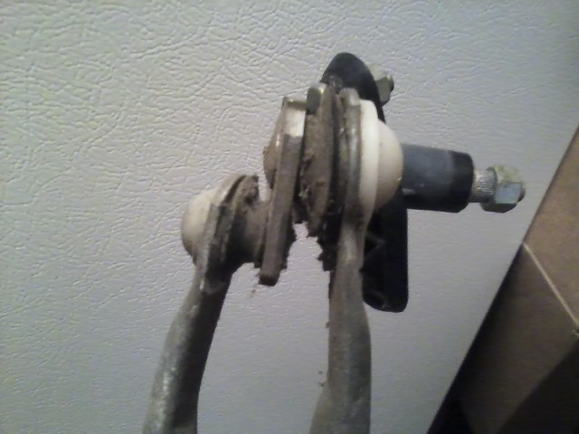

    Remove the arms. Then take the big nut off the pivots. Pull the three bolts for the motor is. And the whole assembly slides out that hole. It's kind of a pain but it does come out. Then you can work on the ball and socket. It's a plastic cup with a metal ball.

    Can't load the pic PM me an Email address I will send you a pic of one I just pulled for another guy.

    That looks like it broke. You will need to find a new arm assembly. Bummer deal. They have a tendency to freeze up because the grease is old and gone. I had the pivot nut self destruct when taking mine apart.
