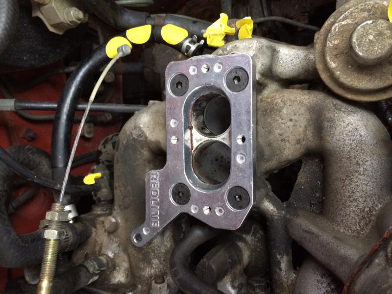

    1. Throttle cable hook-up: I'm a little confused here. The instructions show a 'throttle cable bracket' that should hold the throttle cable in place, but I don't see anything in my parts that looks like the picture in the instructions. The only thing close to what I see in the instructions is the lever/arm shown in the image below. I remember reading something on this forum about certain models of these carbs relocating the throttle cable to the front of the carb (closest to the front of the truck rather than the firewall) - is that what I am supposed to do?
    2.Adapter plates: This probably goes hand-in-hand with my first question. Does this look like it's backwards? The instructions state, "...Install the universal adaptor noting the position of the carb for the cable operation". I assumed that since the throttle cable was near the back of the carb, the arm for the throttle cable on the adaptor plate should be closest to the firewall, no?
    Here's a few more pics that might help?
    At the end of the day, at least this pile of crap is no longer under the hood!
    I sure wish the instructions from Weber cam with more images. I learn much easier through visuals.
    All feedback is appreciated!
    The adaptor plate on the manifold is on backward - leg on the upper plate goes to outside of the manifold, just flip it 180. The bracket in the second pic goes on the valve cover, and the old cable mount that bolted onto the valve cover bolts on that bracket. That means you have to rotate the carb 180 to put the linkage to the front of the carb towards the rad. There should be a piece that has a hole with a nut that the cable goes through - you have to cut the lead end off that went into the old bracket to feed the cable into the fitting. Next time put a tarp over you and the truck so you don't get that snowed in feeling while you work...
    Ahhhh, that seems to make sense! Not seeing any piece that has a hole w/ nut for the cable to go through though - assuming this should be a part from the new kit, right?
    I thought about making a little fort with a tarp to work under but the snow was coming in from all angles! Picture Forrest Gump when he's talking about it raining for days.. except snow, lol!
    Thanks pennyman - I'm going to try and get back at it after skiing tomo!
    in pic #6 - there is the bracket with the holes in it - that is where the cable adaptor goes, and the return spring hooks to.
    oh my look at the snow, lol. Throw a towel over that thing. When you connect the vacuum to the dizzy, it will be the ported connection in this image. You will most likely have to remove the tiny screw and block the other one next to it.
    Use the one most forward on the carb.

    the part I was referring to is shown on the install sheet at the bottom - it should have come with the kit.
