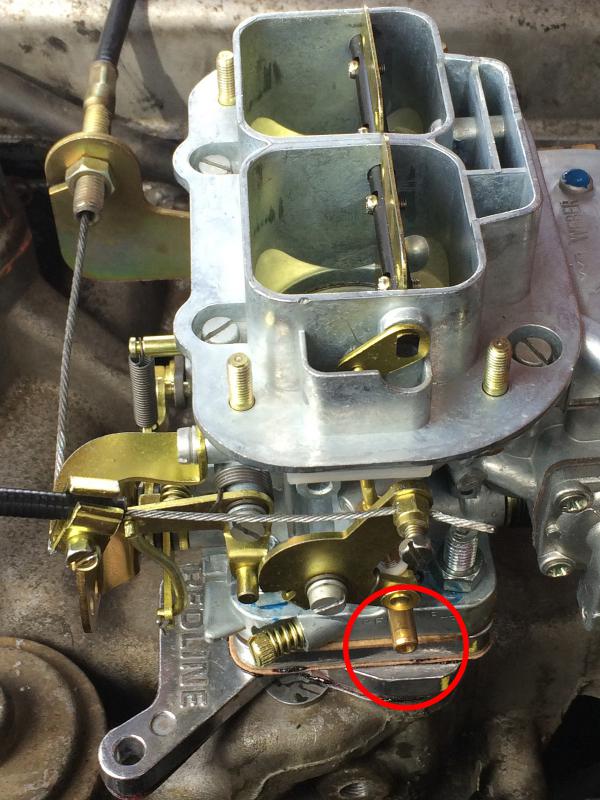

The adaptor plate on the manifold is on backward - leg on the upper plate goes to outside of the manifold, just flip it 180. The bracket in the second pic goes on the valve cover, and the old cable mount that bolted onto the valve cover bolts on that bracket. That means you have to rotate the carb 180 to put the linkage to the front of the carb towards the rad. There should be a piece that has a hole with a nut that the cable goes through - you have to cut the lead end off that went into the old bracket to feed the cable into the fitting. Next time put a tarp over you and the truck so you don't get that snowed in feeling while you work...
