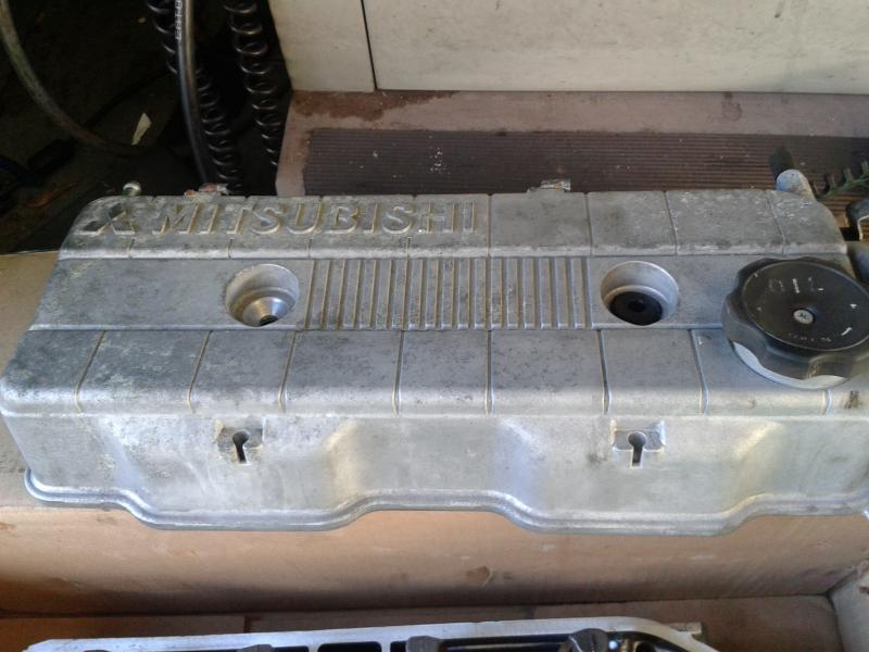

    Corroded valve cover in the same condition it was in when I dropped it off. Hasn't been touched. The gasket is still on the underside.

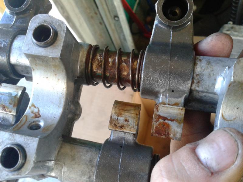

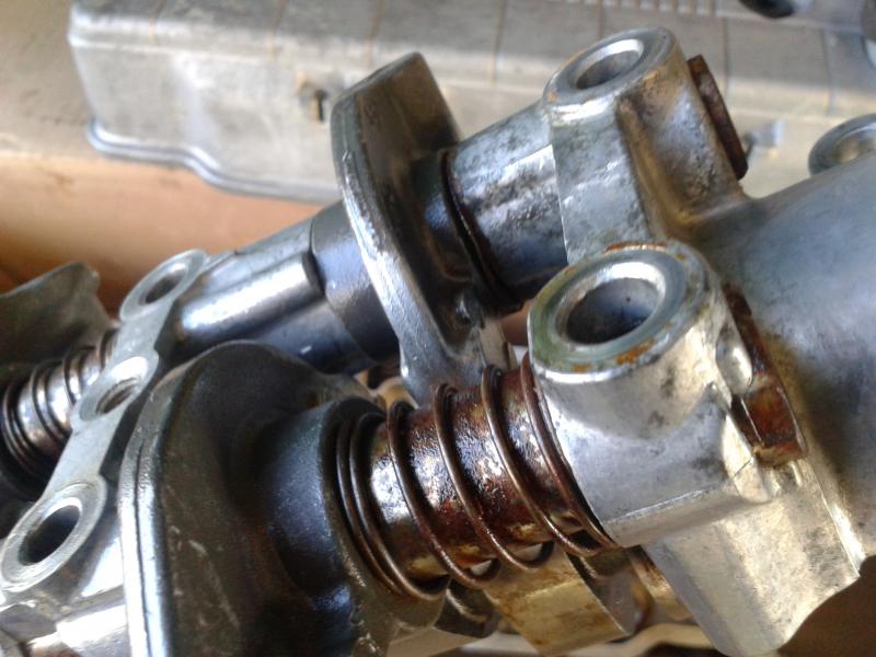

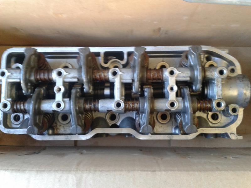

    Cylinder head, valvetrain, cam after the cleaning. He says I can take my jeweler's file (?) and some Scotch Brite and clean up the rocker surfaces. You can kinda see it but the valve stems and valve springs are covered in rust. Did he even disassemble and check everything?

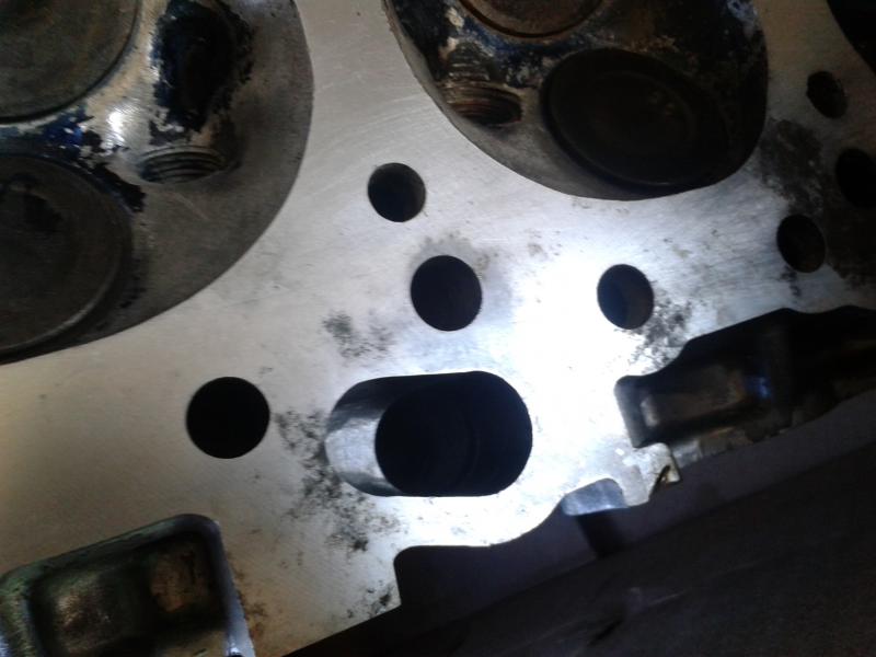

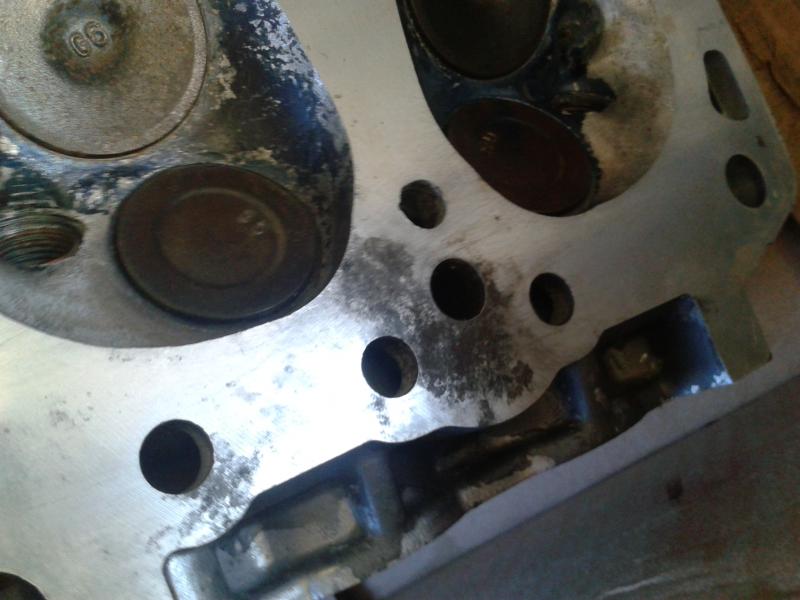

    He points to these two discolored sections on the mating surface and says "you can go over that with emery cloth."

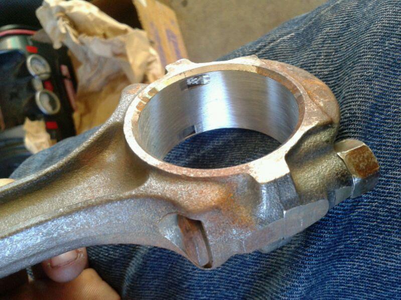

    He honed the bearing surface and cleaned up the skirts with a file but there's all this rust on the rods. You can't see it in the pic but the whole rod is covered in red rust.

    Rocker arms have rust on the pads that touch the cam...excessive wear...you have rust in the cam journal...excessive wear? you can use the old rockers from the jet head, just remove the jet valve actuators... My solid lifters have the tab for jet valves but nothing there to push...
