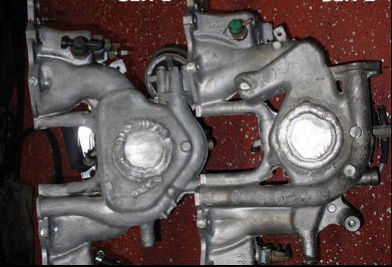

    The problem with making high HP on these motors is the horrible and I do mean HORRIBLE intake manifold design, they literally choke the motor down, even with a bigger carb. That's what sent me on the path to getting the dual carb intake manifold for this engine in the first place. Just a wayyyyy more efficient design that flows way better

    I'm not too sure our intakes are such a choke point, they are pretty much just open and straight shot to the chambers. Combustion chamber can't pull in enough air in a stroke unless something is shoving it in and or pulling it out like a turbo does. Need RPMs and CFMs. The carb would be more of a restriction then our intake on a 2 barrel application besides not able to run up rpms.
    really? you wanna take one look at this thing and tell me it's a straight shot to the chambers? cause i see some HORRIBLE 90 degree dog leg bends and chamber that should be two separate paths being choked down to one. peak of performance airflow and CFM right there....

    intakes.jpg I still don't see a choke point, I see a direction change but not a choke (decrease size).
    That intake you have is a 2nd gen, 1st gen has a less angle change and shorter runners.
    Image above shows 1st gen on the left. Looks pretty good to me. Besides the EGR crap tubing in the cast.
