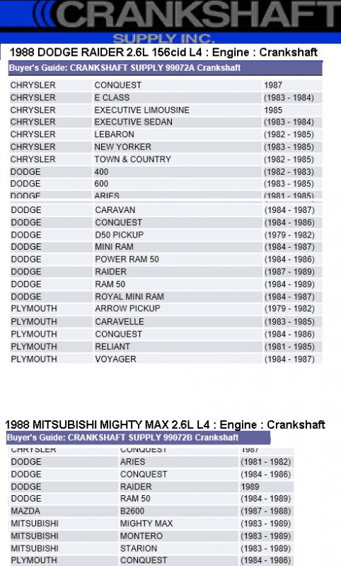

    1988 DODGE RAIDER 2.6L 156cid L4 : Engine : Crankshaft
    CRANKSHAFT SUPPLY Part # 99072A Reman; Includes Bearings
    Mitsubishi G54B engine. Main journal diameter is 2.362". FWD; OE Number: G54
    * Stocked in outlying warehouse--shipping delayed up to 4 business days
    Price$135.79
    Core$50.00
    Total $185.79
    1988 MITSUBISHI MIGHTY MAX 2.6L L4 : Engine : Crankshaft
    CRANKSHAFT SUPPLY Part # 99072B Reman; Includes Bearings
    G54B; OE Number : G54
    * Stocked in outlying warehouse--shipping delayed up to 2 business days
    Price$135.79
    Core$50.00
    Total $185.79
