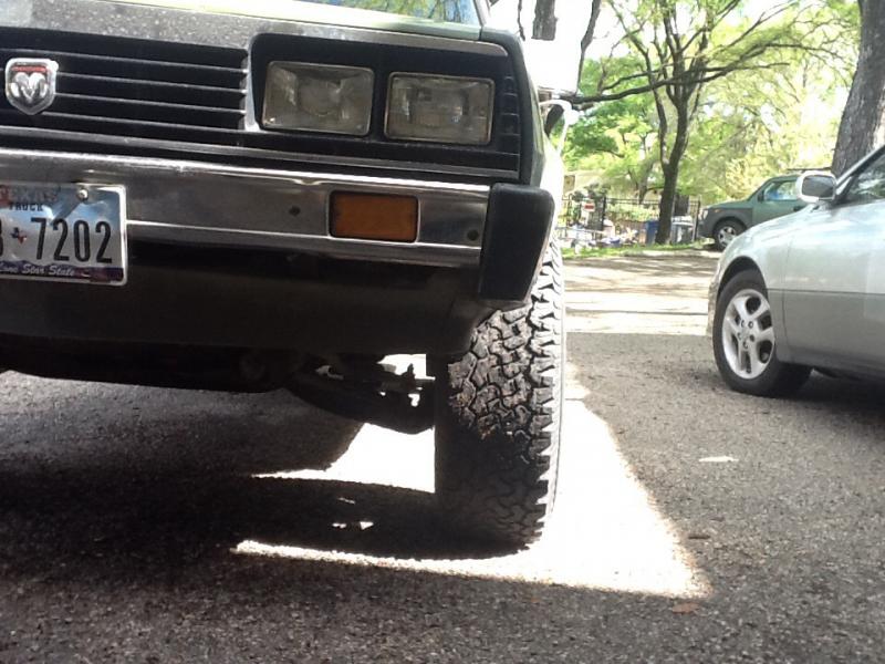

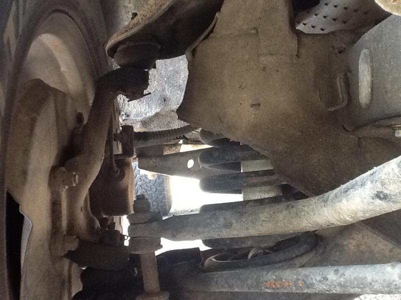

    01-31-2015
    23
    Austin, tx
    A few pics of wheel, bad negative camber, and just pics in general! Sorry she hasn't had a wash in a while
    image.jpgimage.jpgimage.jpgimage.jpgimage.jpgimage.jpgimage.jpgimage.jpgimage.jpgimage.jpgimage.jpgimage.jpg
    The 7th pic is my passenger front wheel that is plum and looks to have an okay bushing. After these pics it seems that I will need to replace the bushing on my driver side wheel before I get it aligned.
    Last pics are of my homemade upholstery job on my dash cost about 10 bucks so You can't beat it.
    does anyone see anything else I'm not seeing I just noticed the bushing on my driver side but does anyone see anything else /have any advice?

    So I think my bushings are fine but I def need to replace my upper ball joint on my driver side. It's completely "squished". Mechanic shops are saying absurd prices is there any way I can replace this myself? Do I need a special tool? Any help would be appreciated

    I took to the shop with ball joints and bushings. They said that my left upper control arm is "flanged" where the ball joint is and that I have to replace the upper control arm.
