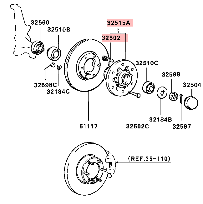

    This is on my 96 Might max , I purchased the truck with escalade wheels on it and the guy used the wrong lug nuts, Now I have the correct Acorn/bulge style lug nuts and I need to replace 3 wheel studs on one of my front hubs, I can not find a replacement hub anywhere!? Has anyone just replaced the studs?

    studs should be the same - the hubs are different thicknesses for the different rotors - 1st gen solid, 2nd gen vented and much thicker
    Welcome to the Forum Vodavi
    Part number for the studs are MB301509
    Part number for the hub are MB109618

    Yes, you can replace just the studs. you can hammer them out with a punch and then "pull them back in with an socket and a nut on a stack of washers.

    Used the mitusu part number cross reference at o'reilly in town and got them for $1.99 a wheel stud , and they had the 6 i needed in stock! Thanks for the help! Job was not to bad I give it 4 beers
