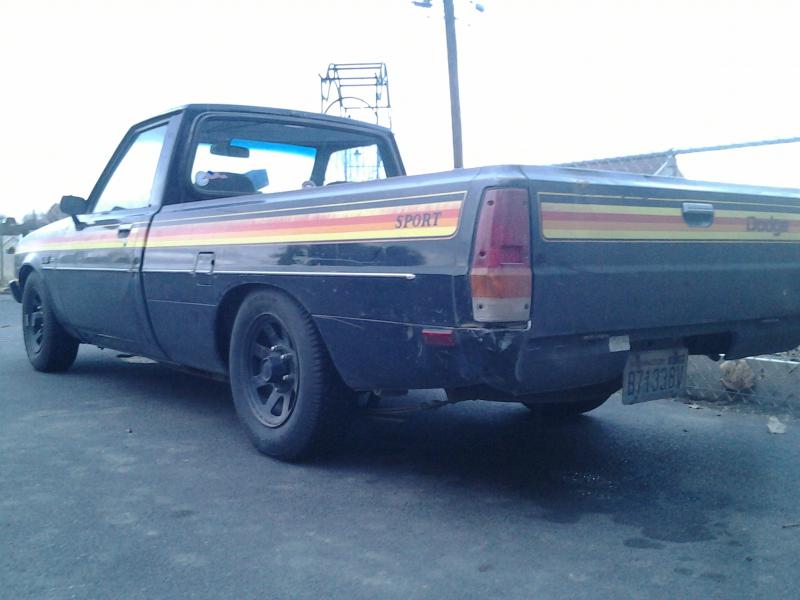

3/4 drop, front grill and bumper painted black

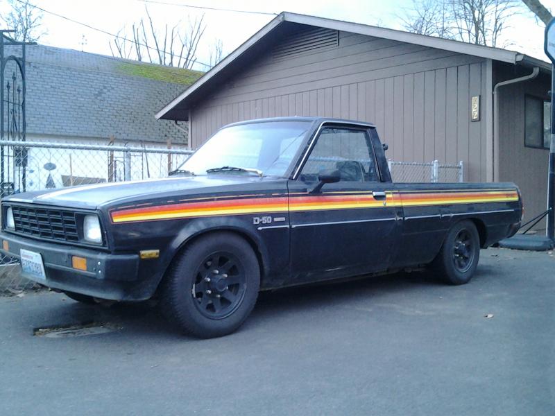

Removed bigass rear bumper

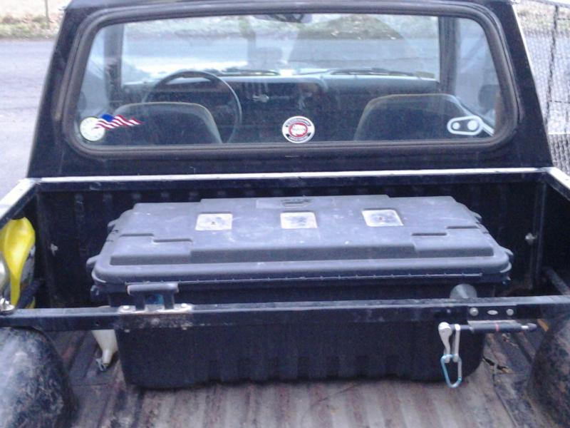

swapped out the slider rear window for a solid one, and threw in a box with some skewer mounts for the bikes

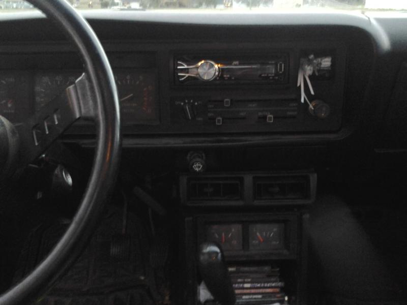

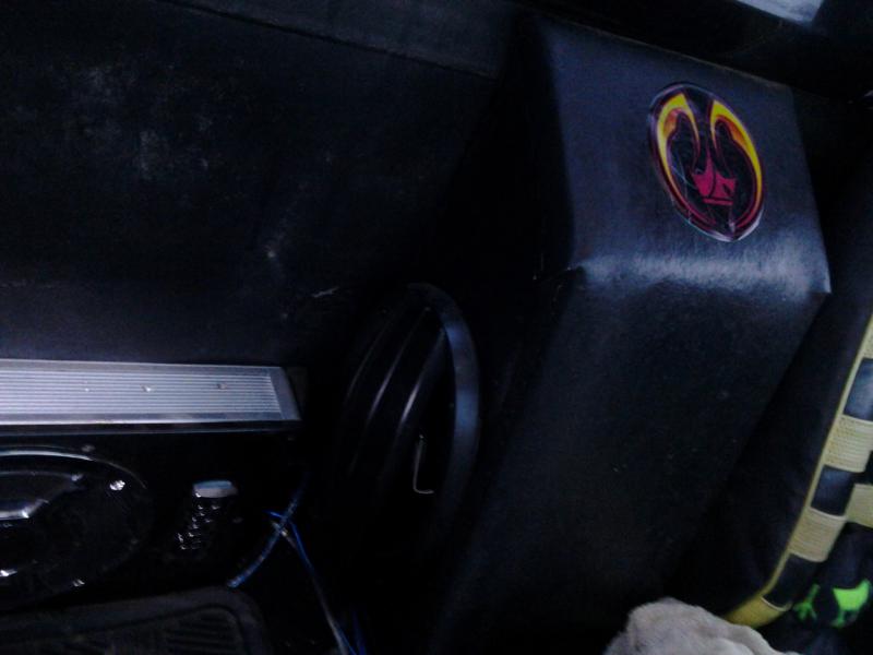

cleaned old crusty decals off instrument fascia, installed new stereo(wish I had kept the stock radio in place and just added a hidden modern setup), built a center speakerbox and added a bassbox/amp behind pass seat

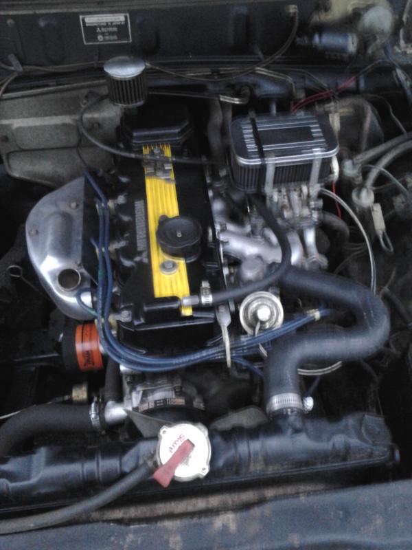

Just recently bolted on a 85 head with a baker cam in it (purchased from the guy my brother bought the truck from locally; no he doesn't have any more parts, I asked...), cut out the center section of the intake for better flow and threw some paint on the valvecover. Replaced the center driveshaft carrier bearing. Truck came with the weber 32/34 was still running the mech fuel pump w/o pressure reg, so I installed cheap inline electric that I need to replace with one that has better flow so I don't lose power when I suck my floatbowl dry at fullthrottle

awesome!...still has the original steering wheel & seats.
3/4 drop? I hope he doesn't mean 3/4 inch drop because that boy is dropped. eeeech it has a fram filter too! (cough cough POS filter cough)
