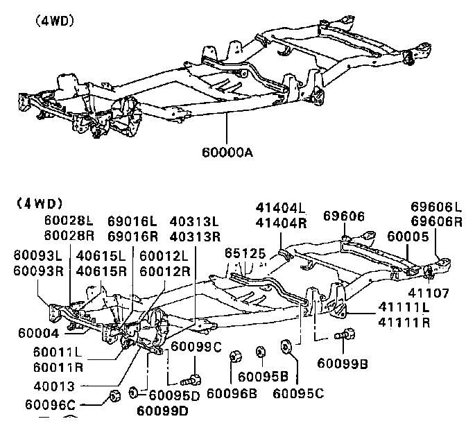

    Can someone please chime in hear.
    I read that you can disconnect the center tranny mount and hoist the motor up, and you can get to it.
    I don't have an engine hoist...Any suggestions.
    Thanks
    Shakenbake
    Use a jack with some 2x4s. Motor mounts may need unbolting, Remember to support the vehicle or chock wheels. Be sure to pop hood or you'll put a nice dent in it. Anything else that might be effected, like short wires pulled or cables, exhaust tubes, etc, will also want to be lifted with the engine.
    As far as disconnecting trany mount...as old as your truck is and if you never replace the trany mount...I'm sure it is already disconnected or delaminated from itself by now, lol. Might as well buy a new one since your unbolting it anyway.
    rockauto might have one for replacement for 10-20 bucks

    Thanks Brad!
    I take it i am jacking it at the tranny..Right?
    Do i need to remove the front outer tie rod or is there enough room to drop it.
    Shake
    Download this manual. http://www.mightyram50.net/d-50/Fact...-1983-1993.zip
    haynes_Pickups_and_Monteros-1983-1993
