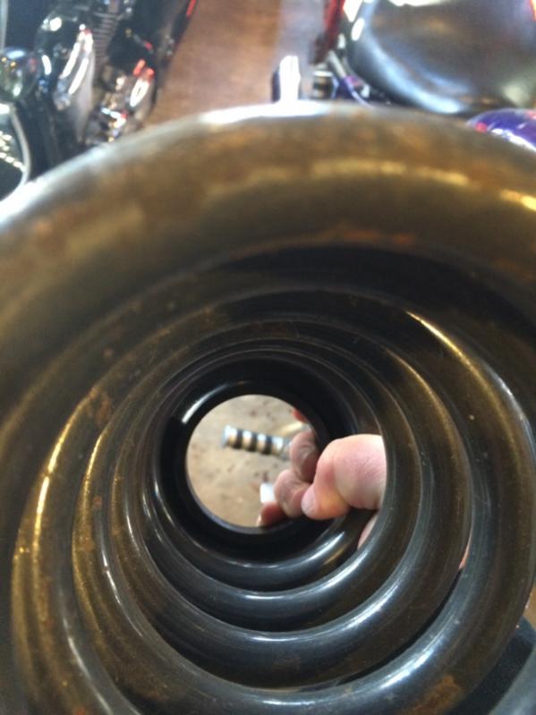

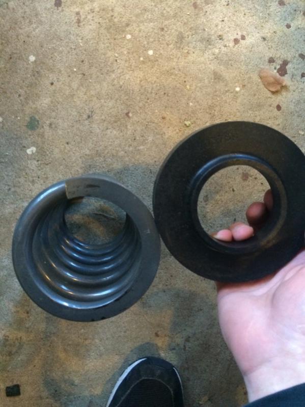

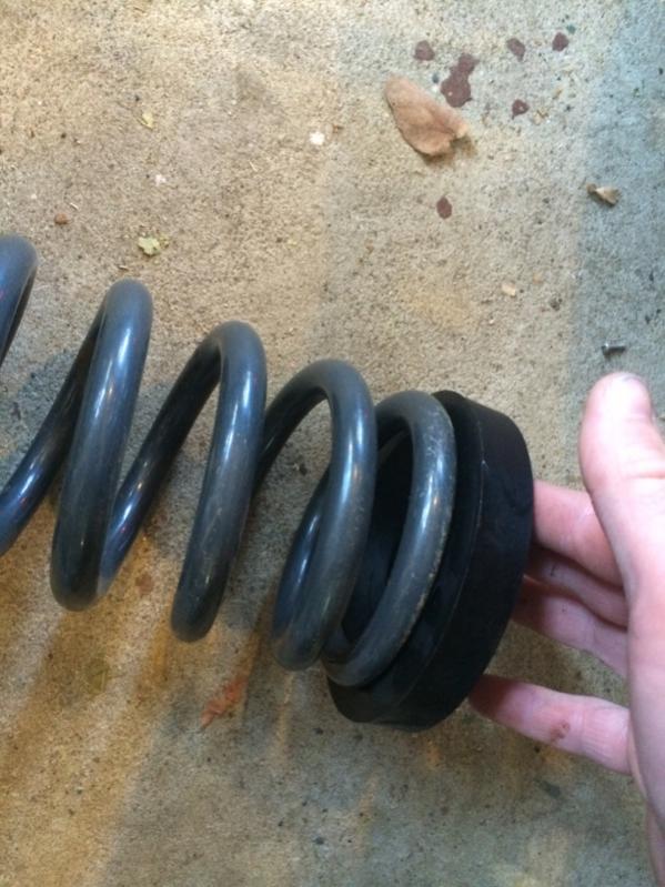

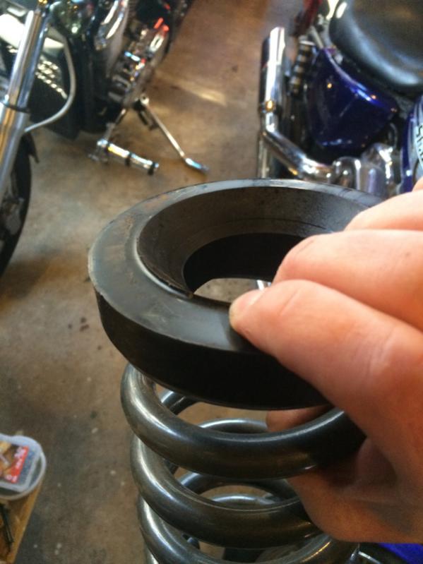

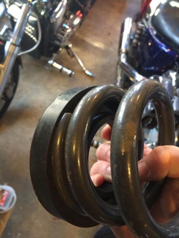

    So this is going to take a couple times, I took a few pics next to one of my drop springs with the spacer. I can only post one pic at a time without my phone acting up

    That looks like it fits the spring pretty well. Do you think it would fit up into the spring seat?
    07-18-2011
    299
    Rockledge, PA
    Maybe? We never tried to fit it. Maybe a little trimming and they would fit for sure.
