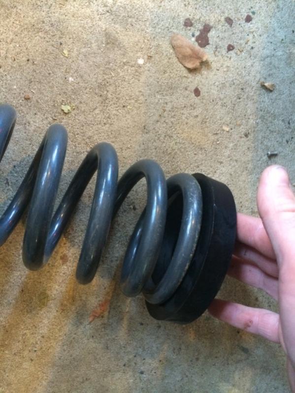

    So this is going to take a couple times, I took a few pics next to one of my drop springs with the spacer. I can only post one pic at a time without my phone acting up

    That looks like it fits the spring pretty well. Do you think it would fit up into the spring seat?

    Maybe? We never tried to fit it. Maybe a little trimming and they would fit for sure.
