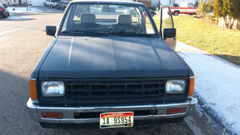

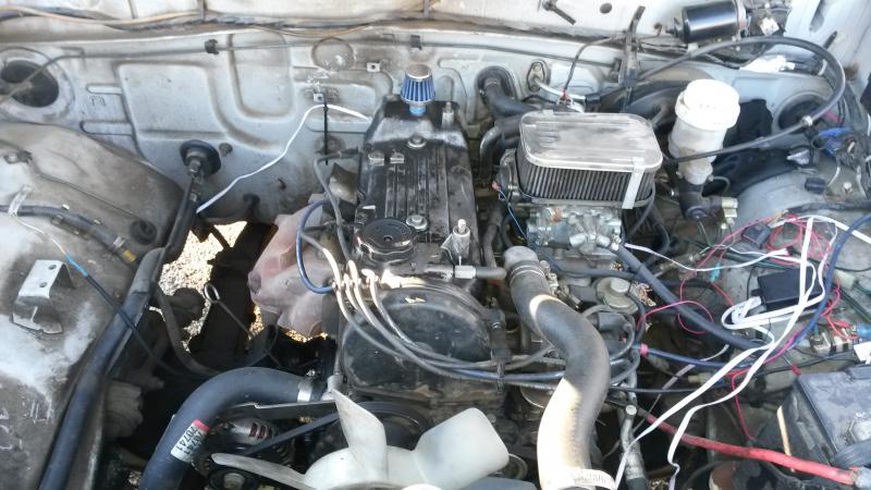

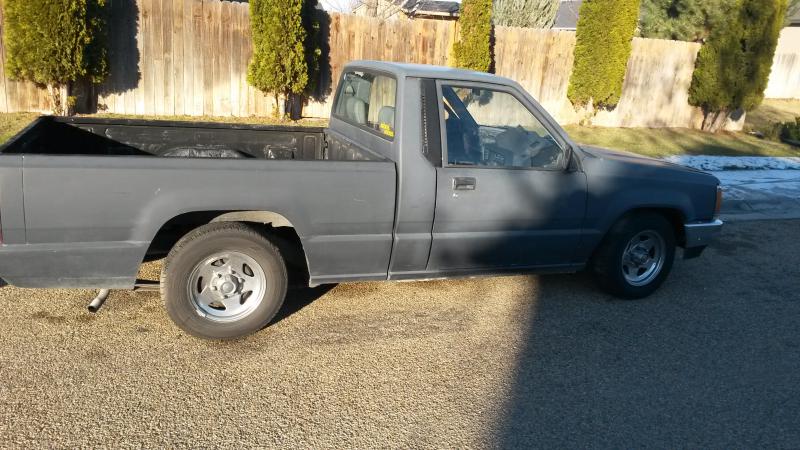

    k so I have a first gen that I'm loving building. However my big ole' ford was a little much on gas and I started getting anxious to drive the little 2.6... but didn't want to rush the build. Solution? Buy another Ram 50 of course! This one is a 1987 Ram 50 2wd with a pretty solid 2.0 that has recently had a head job, a 32/36 installed with a electric pump. I have a few questions that I haven't approached with my 83 so I thought I'd just start a thread for this truck too, as it may be a daily driver now, once my 83 is on the road I'll be building this one too.
    First I'll throw some pictures down.20141226_152455.jpg20141226_152506.jpg20141226_152532.jpg20141226_152557.jpg20141226_152604.jpg20141226_152613.jpg

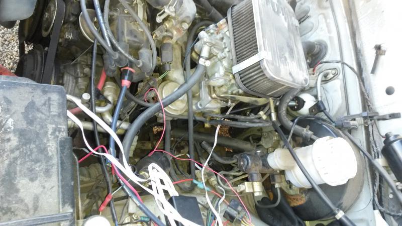

    My first question is about the fuel pump. The ground goes to the chassis and the power is coming split off the same wire they have run to the electric choke on the weber... It takes forever to get this thing to start, and once running it'll run great for a while, then every once and a while, bog down like its completely out of fuel. I'm wondering if this has something to do with the E-Pump being mounted up on the front wheel well, or maybe its just too weak of a pump to keep up with this carb?
    What do you guys think?
    The pump needs to be back by the tank, as it is a pusher and does not do well trying to draw fuel from the tank. Next, connect the wire from the fuel pump to a relay, and run the hot lead from the battery through the relay to the pump - this way you get full +12 volts to the pump. Use 12 gauge or larger (smaller numerically) to prevent voltage drop. For the best and safest way to wire the pump in, see the weber sticky on installing the fuel pump with an oil pressure safety switch.

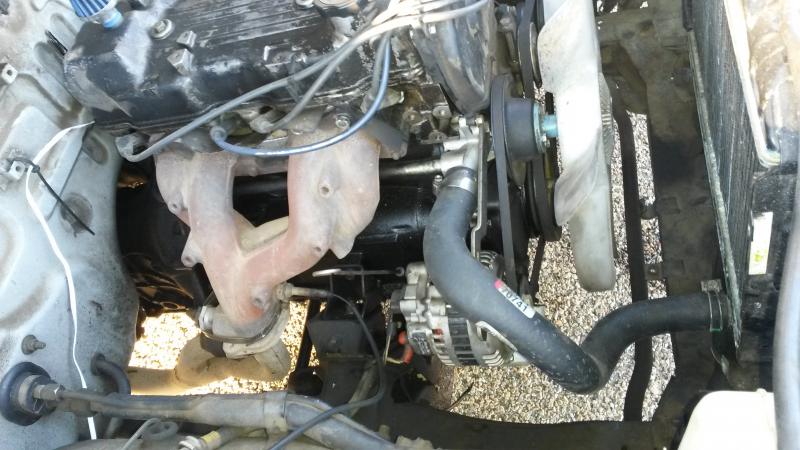

    sheesh looks like a furball of wire. Oh and them lower radiator hoses that are non ribbed and don't have wire in them can collapse on you and shut water off coming out of engine. Keep an eye on that thing, I had one get soft from heat and self squished itself, lol. Remember, the overheating precautions about our trucks. Better to over do then to over heat.
