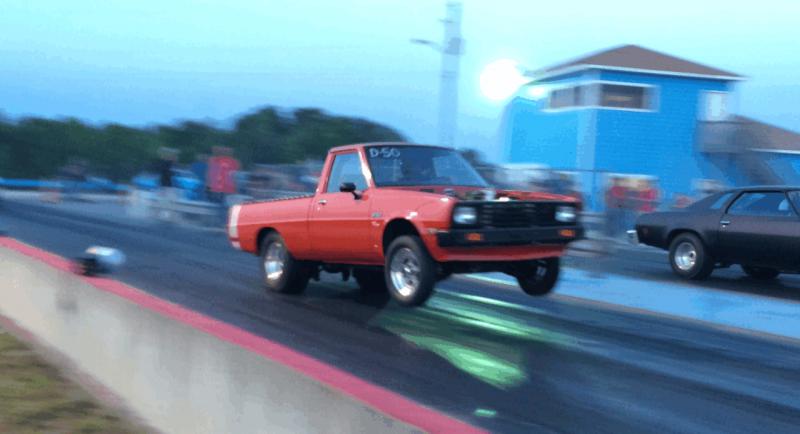

    06-27-2015
    424
    Bothwell,Ontario
    Dodge V8
    We ran 12.30's on a stock rear axle in a 1986 Ram50 with a 360.
    An Abody 8 3/4 is the perfect width..you just move the perches. We had one but never broke the stock rear end so never swapped it in..
    and if you get a later A body mopar 8 3/4 rear it will be a 5 x 4.5 bolt pattern, same as a Toyota or 8.8 / 9" ford
