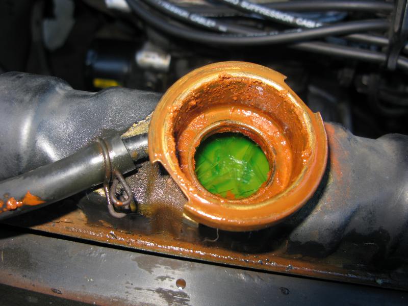

    Okee dokes, so I got everything off except the pulley!!! The radiator doesn't have to be removed. I did undo the 4 radiator mounting bolts though trying to wiggle the fan off without hurting it & almost took out the radiator but discovered ALL the radiator hoses seem to be permanently attached to all their spots.
    Golly gee whiz, think the hoses may be rusted on? UGH!!! Makes me sick just to think about it

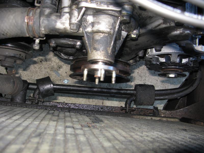

    So after giving up on the radiator for today since I couldn't figure out how to get the hoses off without a blowtorch, I found that there's plenty of room to remove the crank pulley as long as the fan is out:

    Luckily the biggest socket I have matches the MM for that pulley nut .. BUT .. I couldn't figure out how to get it off. I sprayed the heck out of that big bolt with that stuff to make it easier to take off bolts, but no go. And of course there's no one strong to help me at home today! Then when searching to find out how i had the most horrible thought:

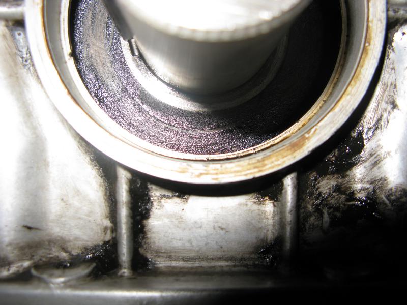

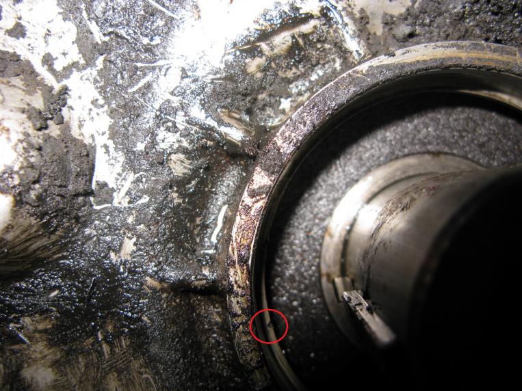

    Okee dokes, finally had a little victory and got the pulley off this afternoon.
    Cleaned it up enough to take pics inside and 1 little tiny area concerns me: (red circle in 2nd pic, same spot on both, right opposite that sticky-outty part I can't think what it's called at the moment)

    I looked around and couldn't find a pic with an end of the shaft view like above, so I don't know if that is supposed to look like it does or not.
    Would GREATLY appreciate any info or pointers very much!!! Unsure if I should put it back together as-is or not. *shrugs*
    4,304
    the seal should cover that when it is installed and not leak. The part off the crank shaft is the keyway to locate the crank pulley.
    Thanks! Thank you! That IS what it's called, yes keyway. Yeah, was hoping the seal would, but felt lost not knowing what I'm looking at. Too dark yet again but will put it all back together in the morning & hopefully no more leaking from there at least. Might as well do the radiator tomorrow too, will be above freezing temps. So may take a while to be 'done'.

    for future referance if you need to get stuck radiator hoses off loosen the clamps and move them, get a pair of channel lock pliers loosely grip the hose and rotate slowly back and forth it should break loose. if the hoses are older they may tear. remember to not squeeze to tightly on radiator or heater core connections as the metal is soft and can deform easily. hope this helps

    Ah yes, didn't think of the channel locks, thought about a sawsall though lol. That's a better idea thank you!! I do expect them to tear or / and crumble. Getting them to do either would be progress

    With a rusty bunch of radiator stuff to remove, especially the radiator ya got to be careful not to crack the hose attachment necks on the radiator and what not. If I have a hose that is glued on by years of use, I'll just cut that sucker with a blade.
