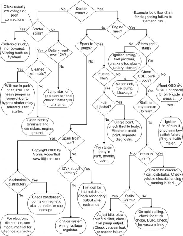

    Anyways, the 3 things you need to concentrate on specifically, SPARK, FUEL, Mechanical
    Here's a flow chart I found.

    The distributor was just another factory one and the coil is a accel super street and the rockers are factory with hydraulic lash adjusters. I forgot to mention that before I tore this thing down I checked the ign timing at idle was so far advanced I have to estimate it at 25deg advanced. I'll check out that flow chart
