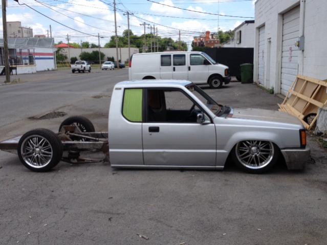

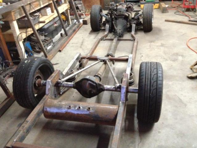

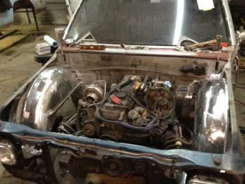

    Here's a few build pics of one of my current trucks. Its a 88 mighty max that's stockfloored n bagged with triangulated 4link and Firestone 2600s all around. I've also put a ultra low milage conquest motor in it with a t3/t4 turbo. I built a 15 gal stainless fuel cell and narrowed a Dana 44 from a Jensen interceptor that has a great posi unit and 308 gears. To top it all off its also stretched for a long bed which is in the process of being body dropped. Enjoy the pics and I'll update as I go.photo-2.jpgimage.jpgphoto-1.jpg
