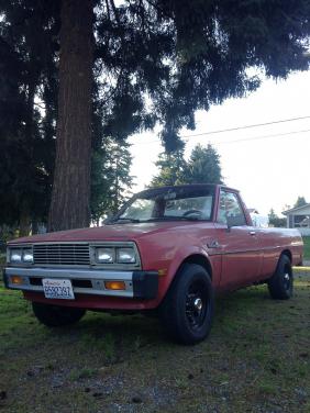

    Hi guys, New to the forums here. I'm an owner of a 1984 Dodge Ram 50 with a G63B 4-Speed. Bought a little over a year ago as a daily driver, not too many problems with it other than the clutch which I replaced a little over 5000 miles ago, and more recently some carburetor issues. I'm a pretty inexperienced mechanic, but I love this truck a little too much to give up on it. Hopefully I can learn a few things from your good ol' community.
