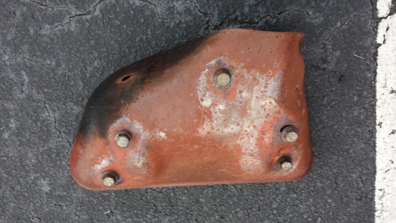

    Here is a pic of the shield I started with. The old paint wasn't the correct kind, not nearly high enough heat threshold. Also, the bolts were crappy ones from Home Depot.

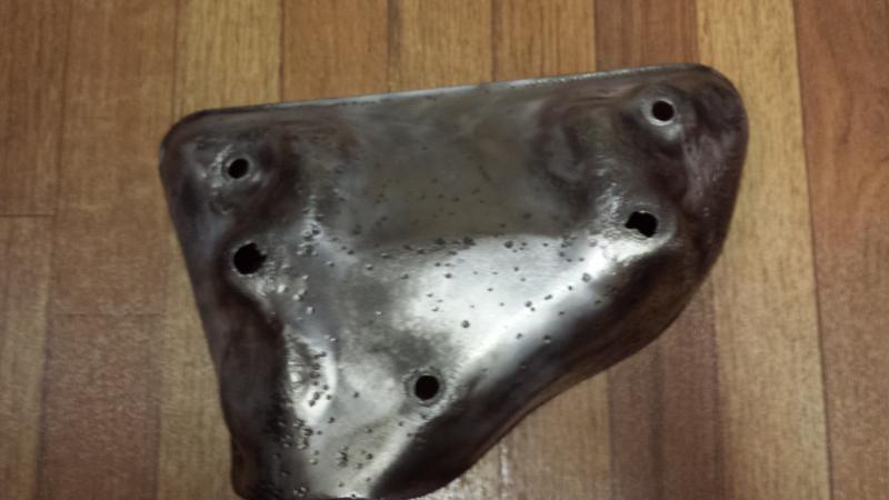

    I almost solely used my angle grinder with a wire brush attachment to strip the old paint and oil residue off. I gave it a good cleaning with oil and grease remover and a scotchbrite pad.

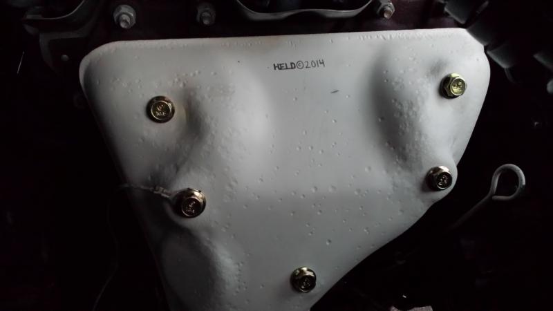

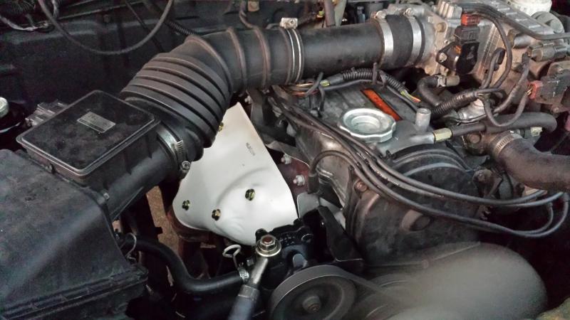

    So what do yall think? I am very pleased with the end result. I wanted to put my last name much larger and in a cool font, but it proved to be much more difficult than I anticipated. So I gave up and just did it real small in Sharpie. If it messes over time, I still have the can of paint. Ill just strip it and go again. No biggie.
