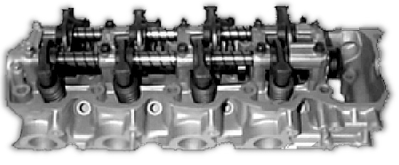

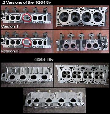

    nope, the 2.6 is evenly spaced exhaust ports and the 2.4 has paired exhaust ports sorry

    4G64's
    Even and Paired / 8v & 16v
    4g54
