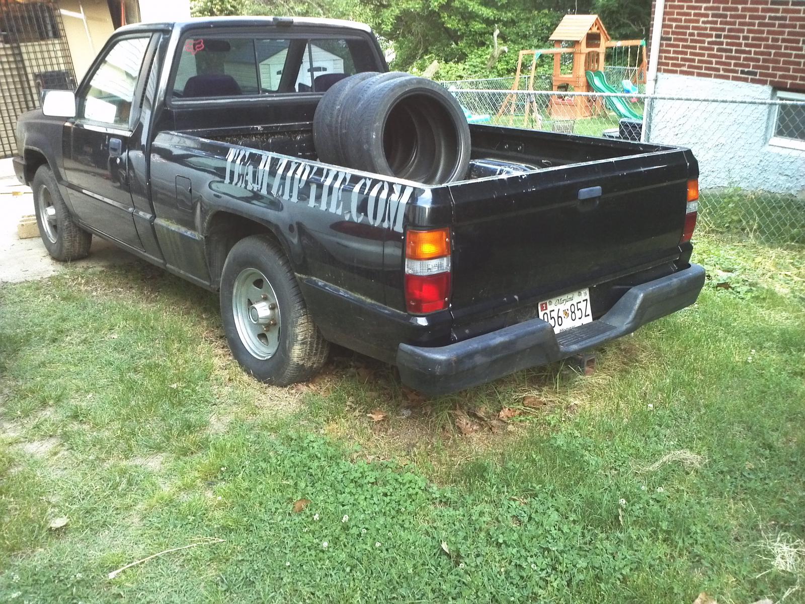

    So, some pictures and a quick walk around:
    First off, we have two good tail lights plus a third in the garage, factory chrome rims with center caps OE style bumper that fits correctly, and class 2 trailer hitch.

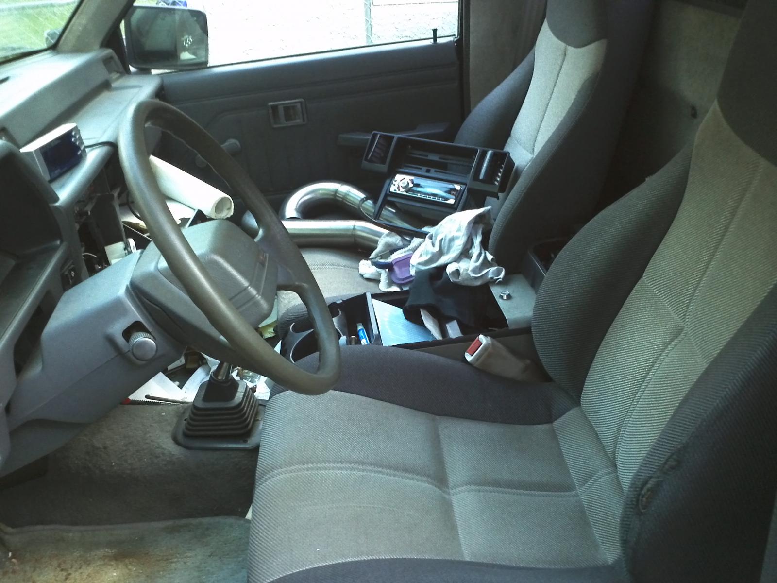

    Next we see the interior. No stock floor mats, unfortunately. Seats out of a Camaro. Driver's side is functional 8 way power adjustable but there's no room to go anywhere with it, lol. Put those in when all I had to my name was a hack saw. The brackets are made from home depot hinges and are not that great. But I did put her straight into a guard rail at like 40 mph and they held. so did the seat belts.

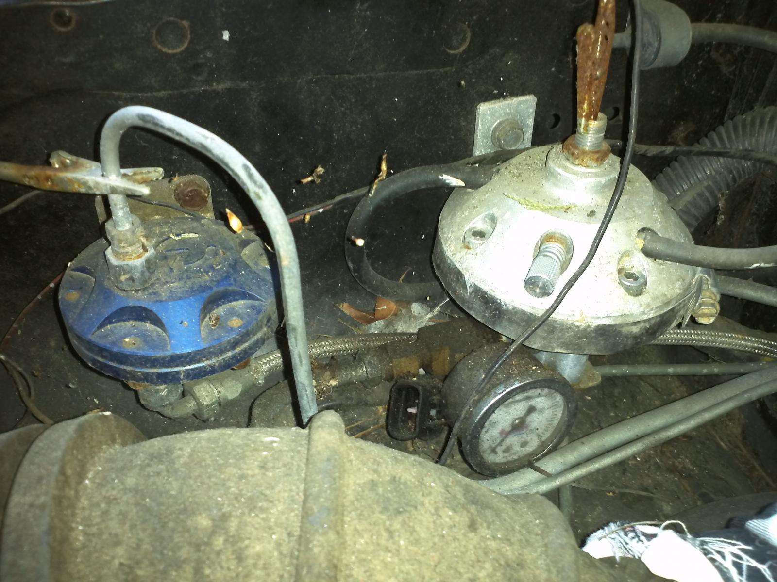

    Over here, we have a rising rate fuel pressure regulator (the silver thing), boost referenced and adjustable for initial pressure and rate of rise. After thinking about it, I suggest running one of these in series with the stock regulator rather than instead of it as I had done. I think drivability would have been better. Of course, there's the obligatory liquid filled fuel pressure gauge. The blue thing is the fuel pressure gauge isolator. Gas on one side, antifreeze on the other. For safety... The alligator clip is there for grounding out that terminal you have to ground out when you want to adjust the base timing by turning the distributor.
