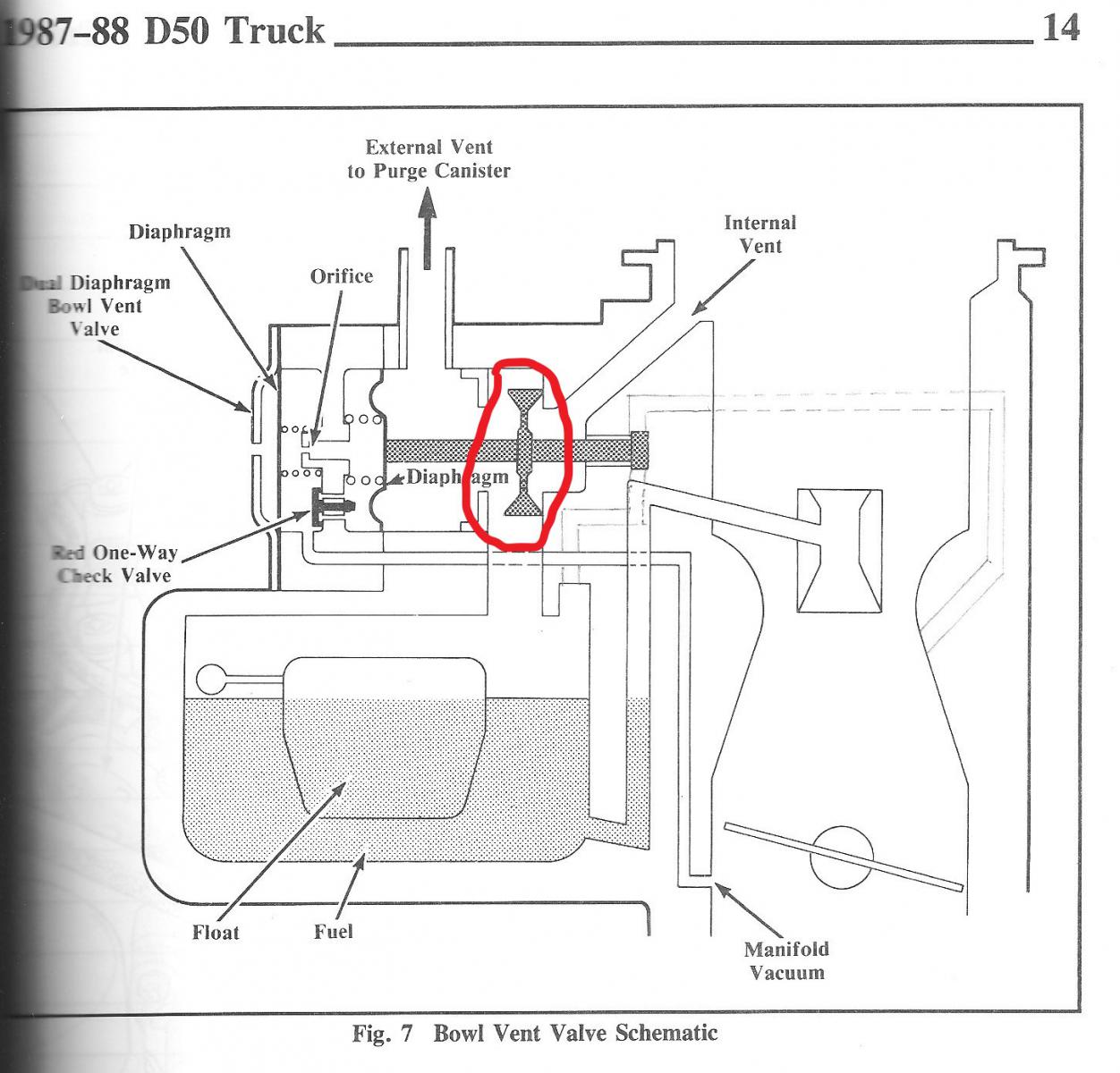

    It was running fine, and then not--it really started to sound lousy, running rough and hesitating. After a lot of research, I had the problem about 80% diagnosed as a bad bowl vent diaphragm. After DAYS of searching, I was finally able to locate one of these diaphragms over the internet. It's a little rubber ring on about a 3" shaft, and "pops" out of the carb sort of like the axle on a front-wheel-drive car. Anyway...
    The new part arrived today, but when I tried installing it, I encountered resistance. Turns out the gasket on the receiving end (DEEP in the carb!) had become unseated, and was rattling around loose--thus, it wasn't grabbing the shaft like it should, and me forcing the shaft in was only making things worse.

    I appreciate the advice. I actually managed to install the new bowl-vent diaphragm, which was nice, and when I tested it all seemed well. (Disconnect vacuum hose running from vapor canister to carb, at the canister, and blow through it--if you hear air running through to the carb, the diaphragm is shot. I heard air with the old part, but not with the new one!)
