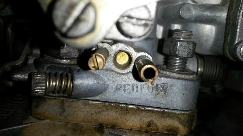

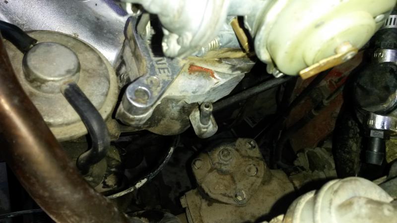

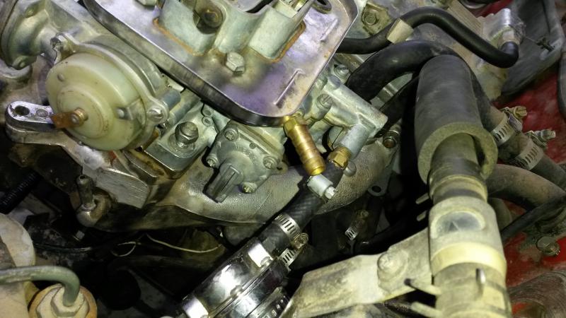

    I have the dizzy vacuum line and I need to know where it goes. I have 2 ports open that it'll (kinda) fit. One on the intake right below the carb (pictured) and one right below the e-choke (also pictured). Then I have my 2 ports on the firewall side of the carb. One of them had the regulator on it because the donor truck had an electric fuel pump. Therefor I'm assuming its my "in" port. I'm assuming the other full size port is the one I'll put the "to carb" line from the vapor canistor? What about the final small port that I'm not using?

    Take the screw out of the one on the left at the base of the carb in picture #3 and connect your hose to that one. Cap off the one on the right. I made the mistake of using that one closest to the firewall and didn't realize it until I had my dizzy curved.
    Tighten that carb bolt too, looks like it is loose, lol.

    lol thank you brad! I never would have guess that I'd have to uncap that!!
    Yeah I was in the process of unbolting it.
    Got a new gasket kit for that conversion plate and carb, was installing it.

    Okay I went and got myself confused again. Brad said to hook the "to carb" line from my vapor canister to the base of the carb on the valve cover side so pressure vapors from the tank go to the carb for burn off. But that port is already hooked up to my valve cover?
