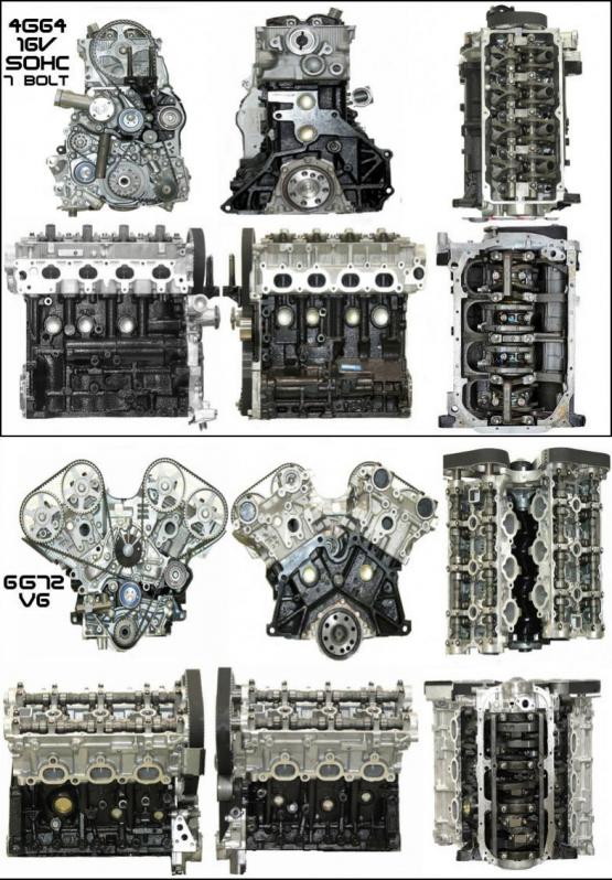

    Ok, so I got my hands on a cheap 6g72 out of a 3000gt. I have a MM with the 2.4l. I was wondering if the v6 will bolt up to my transmission or not?
    I am not sure what your 4G64 is, if it's a twin cam or SOHC, Automatic or stick... as also with the 6g72, this information should be supplied with your request post to get your answer more accurate. I looked at both these engines on our Wiki section and here they are. By just looking I would say no way. The bell house on both engines are quite different from each other. But, don't take my word for it, in here anything is possible and there probably is some way to make it fit.

    4gXX does not bolt to any 6gXX.
    Your only option for a RWD/2wd 6gXX engine swap is sourcing a RWD 6gXX trans from a Montero Sport. Good luck with that.
    Option B is to adapt it with a machined adapter or something of that nature.
