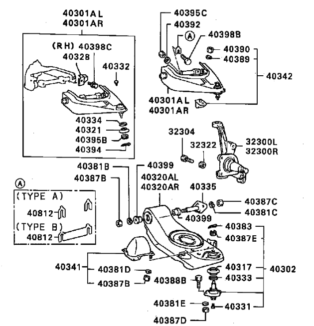

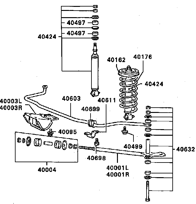

    did you replace the lca, idler arm, and strut rod bushings? those will cause wander if bad

    Yup anything that was rubber on the truck when I got it was shot. I replaced all the bushings. Pads and calipers are new too. Truck only had 90k when I got it in '12 so I decided it was worth it to fix it up. Replacing bushings really isn't that costly if you do it yourself.

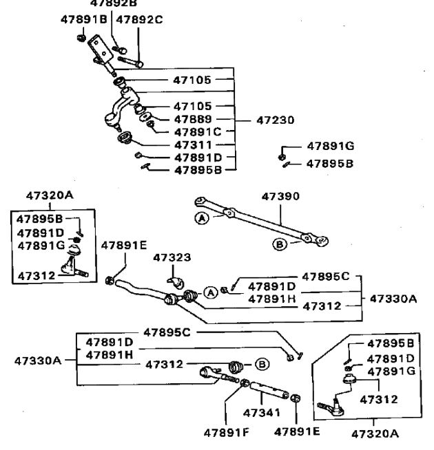

    I took off the driver's side tire today to check out the gear box. I can wiggle the wheel 2" either way and the pitman arm doesn't move. I don't know what the tolerance is for these trucks but that seems excessive to me. My guess is that the wookie sound is coming from the box but I don't know what's causing it and I don't know how dangerous it is to keep driving it.

    Any movement as play is concerned is not a good thing. The bushing maybe bad on Idler and without really giving it a stress test might not show. Any alignment shop will or should refuse to even try to align a vehicle with suspension play in any parts. I use a pair of channel locks on suspension parts by grabbing the joint and squeezing them together. This can help show play that usually our grabbing and shaking doesn't always show up.

    if the pitman arm doesn't move but you have play, that is either the center link is shot and/or tie rods and idler
