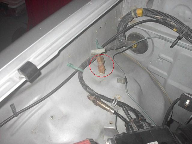

runs rich so rich it left black on my carport and plugs black as can be when I took another look at them they are only three weeks old
Idles rough,has a miss
bucks at low rpms when accelerating I would say 1000-1200 rpms(no tach)
I have taken a look at the vacuum lines they look like they are correct but the diagram was a tad bit confusing that I found anyone possibly have a link?
No check engine light which is odd to me usually with my old 1991 s10 it would throw a cel when anything was wrong
