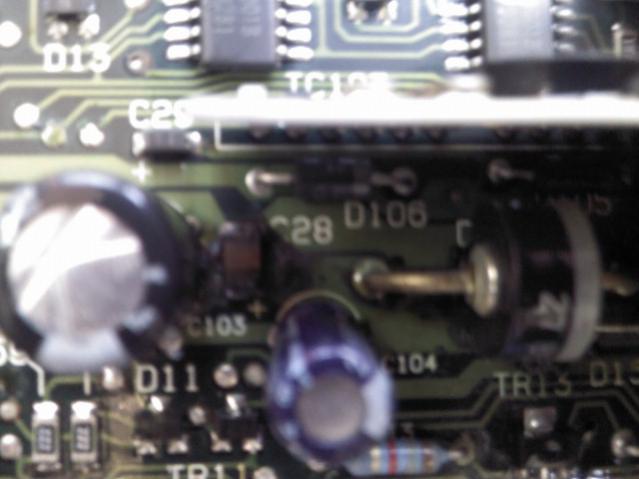

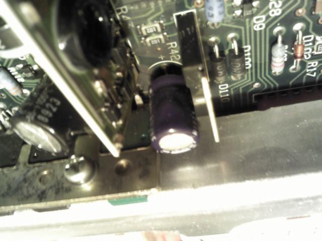

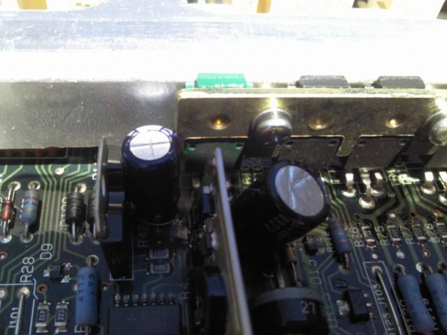

    beware the problem could be the ecu my truck has had a problem for the past like 6 years(was grandpas) and until it died one day neither my dad nor i could figure out the problem so i would pull it out and just check the capasitors on the board and make sure nothing is going bad. i have pictures posted in my project log of the damage to the ecu

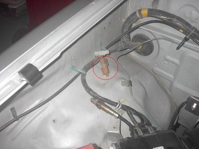

    Vacuum doesn't control the timing, the ECU does, the base timing has to be set with the ECU timing adjust pin grounded. pin is in this plug on the passenger side.
    base timing is 3-7 degrees BTDC
    procedure is in the Haynes Manual page 1-36

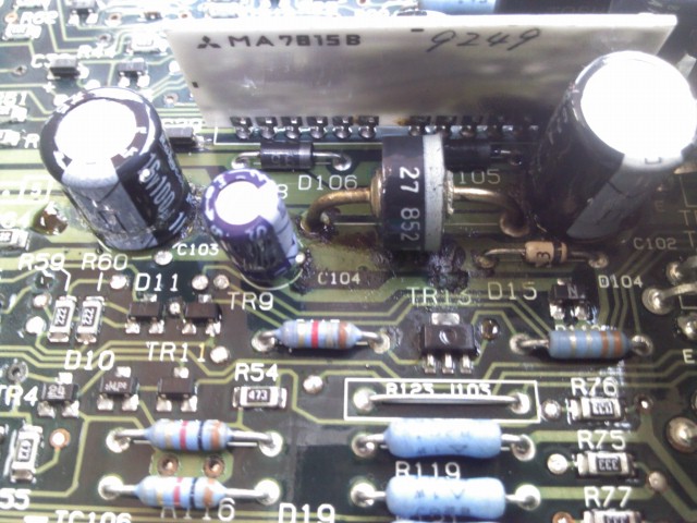

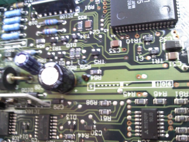

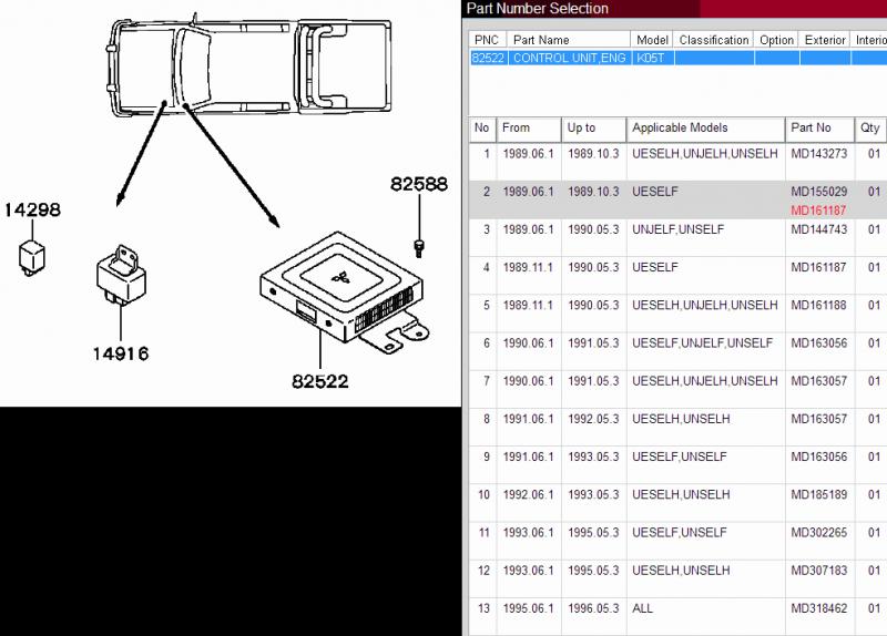

    Ecu (mD144743 E2T34172 9725 A) on top of ecu side )4743 E2T34172) photos it looks like somethings gone a little bad ?
    08-09-2014
    14
    United States

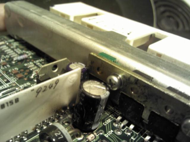

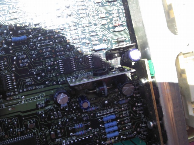

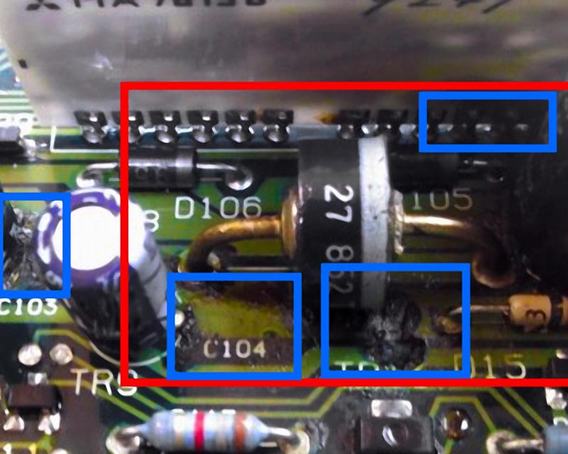

    Ya I see some crusty circuits there on that board. Here is an enlargement of the area, looks charcoaled. Strange that a capacitor didn't pop it's lid on this short. Looks like it got very hot though.

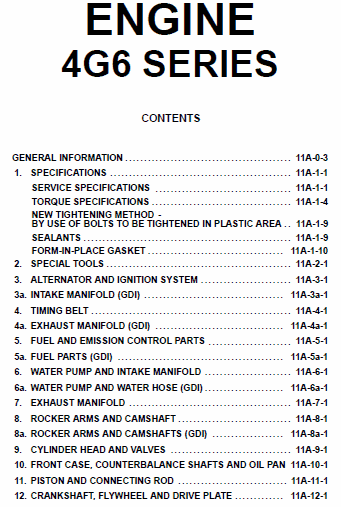

    Here is a pdf that may help if it fits your specs.
    ENGINE
    4G6 SERIES
    4G6 Engine.pdf
