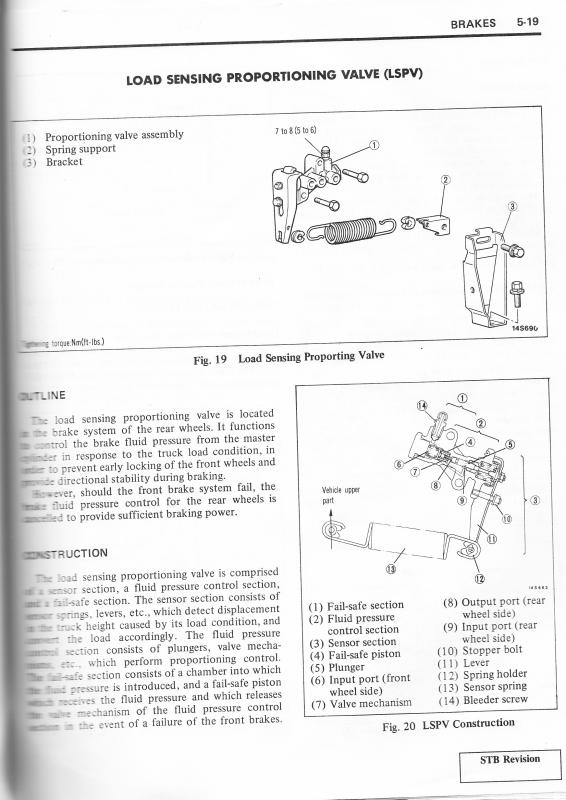

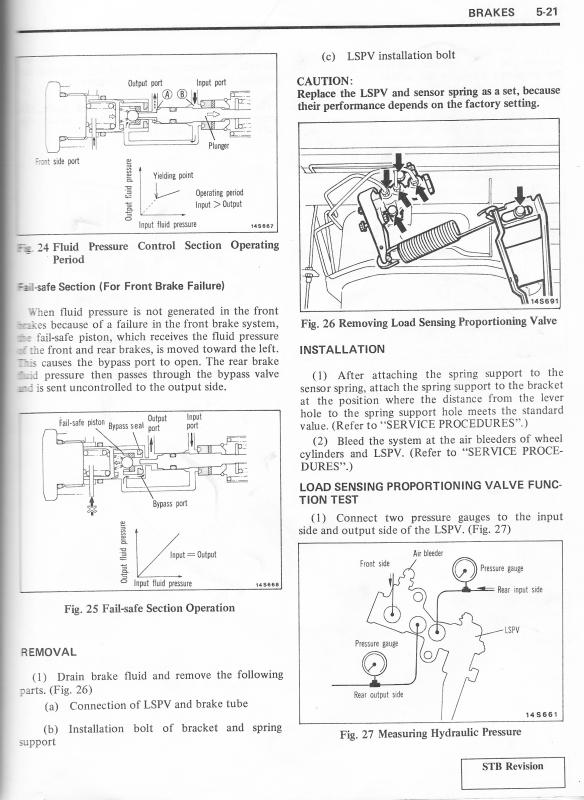

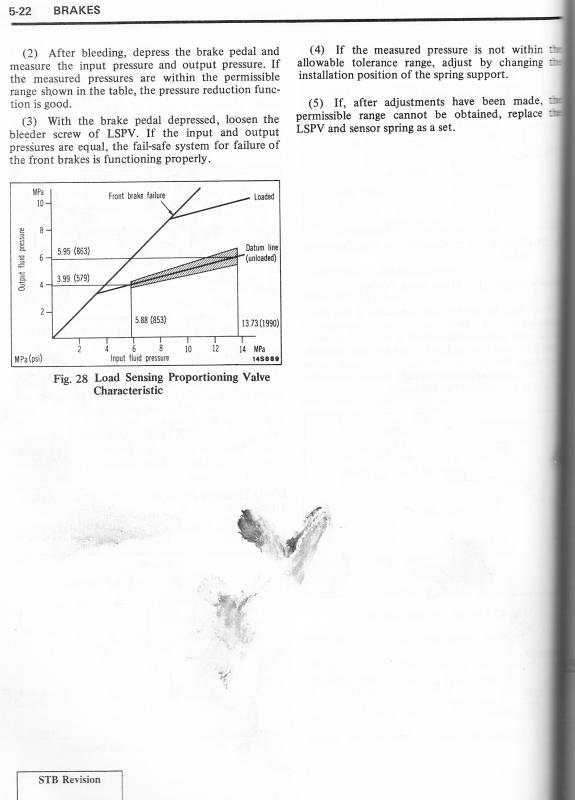

so...you press on the pedal & it depresses to "normal" level & it just doesn't stop til you reach the next town...IMG_0001.jpgIMG_0003.jpgIMG_0004.jpgIMG_0005.jpg...i had to replace valve & spring. try adjusting first & see if any change occurs....then bleed...also verify lines are not clogged/collapsed anywhere else.
