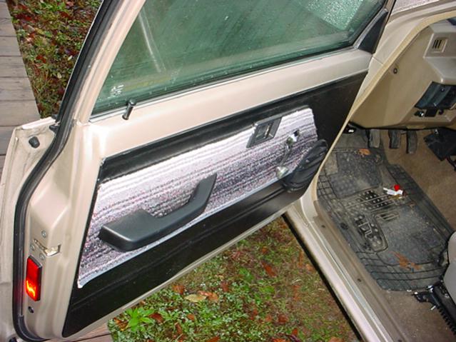

    Below: my door card modification. Might not be your style, but ideas stem from thinking outside the box.

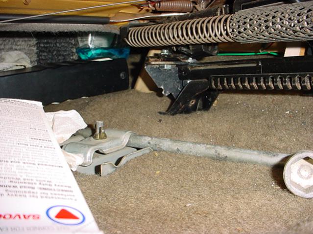

    Took some pictures of mounts. This should help you locate the existing holes/bolts, and give you some idea as to height.
    Driver side, front of seat
    Passenger side..note coordinates: seat belt, wrench mount, bolt. Yours' being 4 x 4 and a bit newer shouldn't make much difference. The bolts are in place on the rear mounts to keep water out of the cab, so you should see them (or caps/plugs).

    A quick note on my door panels ("cards", some call them) - I simply used vinyl paint and incerted cloth (after removing vinyl in that area) using spray adhesive (industrial strength). The experience was good for me, and my future plans are to create totally new door panels with nice materials that look a bit more "factory". The metal door top is a personal choice, for me. The self-adhesive chrome strips are staying put very well. Chrome replacement window cranks are available in the "Help" -brand section of any auto parts store...take your old one to assure proper fit.
    1,271
    Attachment 11457
    On the floor pan and under your door panel you can see the color that will be on the top of the door if you remove that section of vinyl. Should you decide to go that route, be sure to leave a 1 or 2" flap of vinyl to tuck over the top of the actual panel and staple to the back, using 1/8" staples (tape will lose adhesion eventually, my experience). A thin coat of nasty padding needs to be removed from the metal, and paint thinner does the job well without harming the factory paint.
    I'm not sure, but I think this photo also shows the passenger-side bucket seat bolt, just under the seat belt head hanging there.
