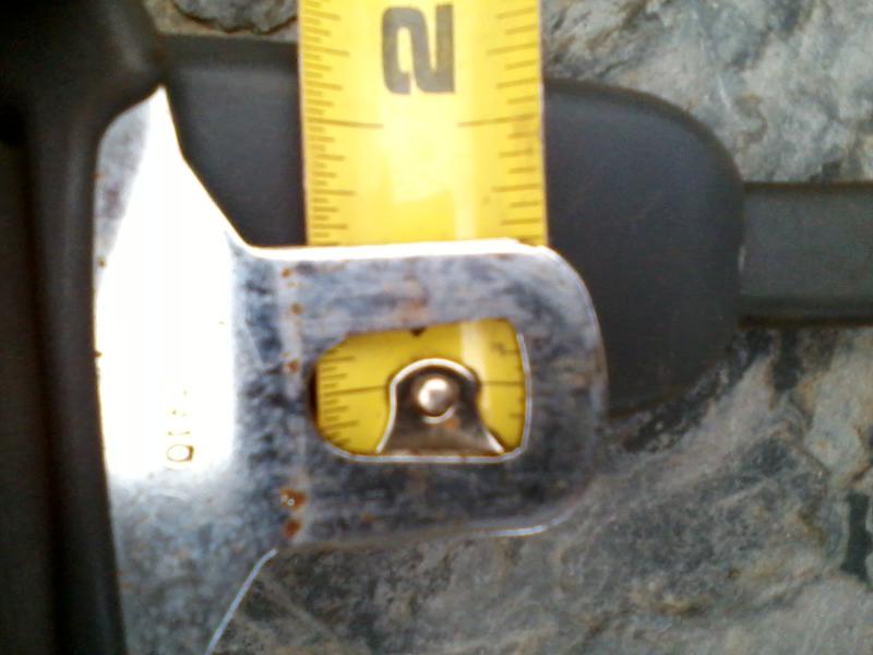

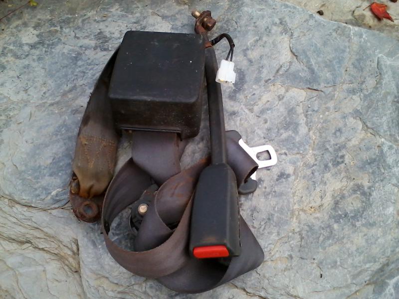

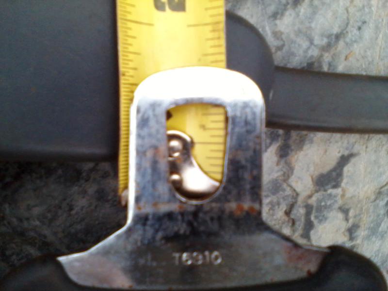

    0923140805-00.jpg0923140806-00.jpg0923140807-00.jpg1st gen (1986)....roughly 1&1/4" wide x 1&1/4" deep.

    re: pictures - got your PM - those do look awfully close to mine. I'll take measurements tonight to be sure, unless someone here can chime in and tell us if the '86 truck's belts are interchangeable with the '88 belts? I know sometimes they carry stuff like that over even into new generations.
    that 86 should work with the 88 belts - they are the same era belts

    Should know by Tuesday - bought 'em from ragragtimetime and he's already shipped. Comparing the pictures and measurements, I can't imagine they won't work.
