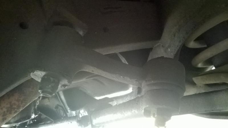

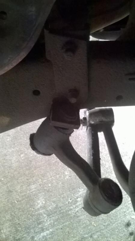

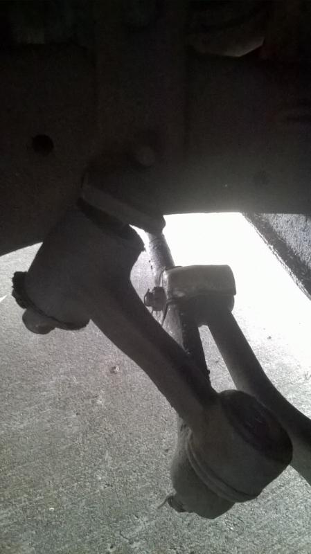

The bushes in your steering idler arm are shot. They only need to be knocked out and new ones pressed in by hand (easy job) You could do it without removing the link end from the centre drag link. I would also inspect the shaft the arm is mounted to for signs of bending and wear.
Freshman
Ah, so it's the idler arm. Then I'm going to order this bushing set for it. http://www.energysuspensionparts.com...rod=MOOG-K9100
Thanks for the info.

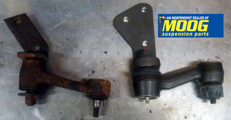

Get the moog heavy duty idler arm. I blew out 2 idler arms towing our boat and replaced the last one with a HD moog and haven't had a problem since. Bushing kits I found were worthless IMO because the arm was worn out and the bushing will fall out or flop around. Try also to get one with the grease zerk fitting installed.
I think they call the "Problem Solver Heavy Duty Idler Arm". I got mine from Orielly Auto Parts
Comparison of parts
