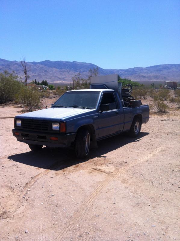

    Ok this is my build thread for my 1989 Mitsubishi Mighty Max.... I traded it for my old trailer... IMG_4834.jpgIMG_4832.jpg I drove from las vegas, nevada to mesquite, nevada... about an hours drive... when I got there the previous owner had filled the the bed with a ton of extra parts..... spare engine, trans, doors,hood, and a bunch of other misc parts....

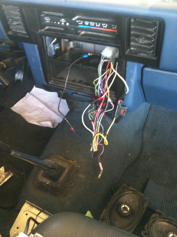

    so i installed the stereo in the truck wired it all up and then turned it on... hooked up my iphone and no music... i was checking the volume, checking the connections, then found out that the speakers were missing... i found them in the glove compartment but they were not the right ones... they dont fit... so i have to get new ones ugh...
    The dash was another story... it was old cracked some of the lights were out... so i found another one from my stash... i cleaned it up replaced the bulbs, and hooked it up.... it looks way better now... a lot brighter with all the dirty and dust gone

    It's coming together nicely - the new rims look great. Doubt you'll find a pair of speakers like the factory items but you can try installing 4" dual cones in there with a rectangular surround plate to hold them in place (break out the tape measure and check if the recess is wide enough)
