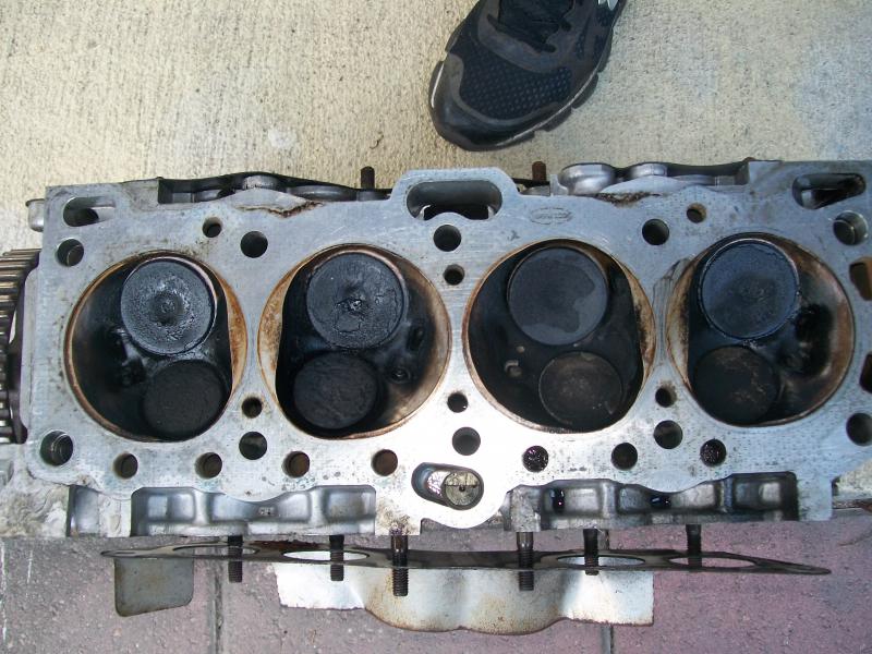

    Hey Artr01.
    The engine has obviously been opened before, by the looks of the gasket residue. I don't think that's an original-factory-gasket.
    My advice is to take it to a machine shop...you can usually locate one through your local NAPA...and have them test it for cracks. Then ask them to re-surface it, if you don't want to do it yourself. Finally, replace the valve seals and you will have less smoking, if not eliminating it altogether.
    If you have the head rebuilt, the block won't withstand the increased pressue and will likely start blowing rings and other uncomfortable personal parts. At 155,000 you have plenty of good motoring ahead, if you take the steps to really vamp this engine up...and it shouldn't take much.
    While you've got the engine this far down, be sure to clear the EGR passages through the manifold and head. Since I have a 4G64, you might benefit from cruising through my thread "Roy's Garage" http://www.mightyram50.net/vbulletin...ll=1#post26192

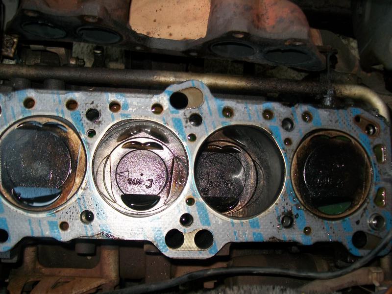

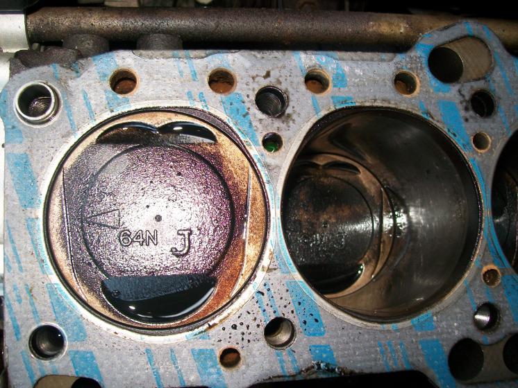

    1,271
    In this photo, it appears to show a breach between #3 and #4 cylinders.

    You're quite welcome.
    From the photos, I'd say the head gasket was breached..."blown" conjures up mental images of metal shrapnel, or my first wife. "Breached" indicates a slow leakage...again, hey! just like my first wife...that certainly affects everything else.
    But do let a couple other members chime in: I could be missing something.
    To me it looks like coolant is making it at least into #3 chamber as the valves are partially de-coked. The adhesive residue from the head gasket around #3 bore on the exhaust side of the block appears to have been scoured off slightly too (bypassing coolant will do this). So the head gasket is definitely the #1 culprit (may have been replaced and not re-torqued at the recommended run in period). Unfortunately you've already pulled the engine apart so you have no longer got the option of doing a compression test to see what the overall condition of the engine is really like. Yep, I'd send the head off for testing and have it overhauled. I'd tend to think you "shouldn't" need to do a bottom end tear down and rebuild at this point. If the head is solid you will only need to give it a light skim, a valve cut and some new stem seals and you'll be rocking.

    in my opinion the head is most likely cracked between the valves in cyl#3 since it is the one and only cylinder that is cleaner than the rest(water in the combustion process will "steam clean" the head and piston) and is exactly what my truck did it would slowly run low on coolant and would run hot when i drove it the first time but after it would spike and then it would cool down and sit stable due to the head warming up and expanding and no longer leaking coolant but if yours is a worse crack it would just plain old overheat and i had to clean the head with a wire brush attachment on a drill to really see the crack i can get a pic if you want for example
