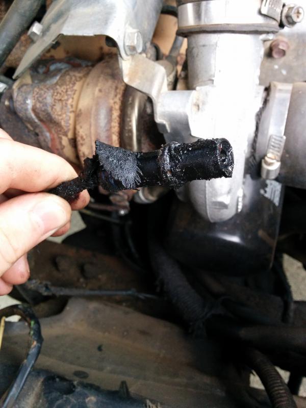

    I also found a mysterious wire that looks like it would go onto the oil sending unit or something like that, but i cannot figure out where the heck it goes, i will upload a picture of it shortly and hopefully someone will know!

    Here is a pic of what i found... any idea where this goes? Found on passenger side, along the frame rail, cannot figure out where this goes? Maybe it was for the original intake somewhere? :S
    That is a sensor plug off the AE92 Corolla I've just finished repairing (it was the filthiest engine I have ever worked on...) It appears to be unit specific so tracking down it's home should be straight forward job - but considering it's condition I would say it is for a ancillary that isn't used on your truck. Blast it down with some degreaser and see what the colour coding and socket type look like as to give you a clue on what it's purpose is.

    well it seems to be very similar to the oil sending unit & coolant sending unit... just slides on a bolt end and measures current/voltage/ohms i assume... i cannot find a spot for it though lol. i will check and see what color the wires are.... its not a usual electrical connection with pins/prongs.
    If its any correlation, its on the same part of the harness that goes to the oil sending unit sensor.

    looking over some wiring diagrams for this thing.... there is apparently 2 sensors, one for pressure, and one for level.... (this was on one of their gas ones but i think it may be the same so im going to have another look and see if i can find the mysterious unit..... :D
