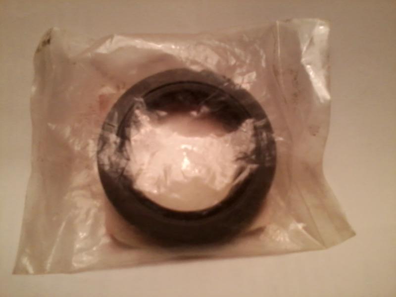

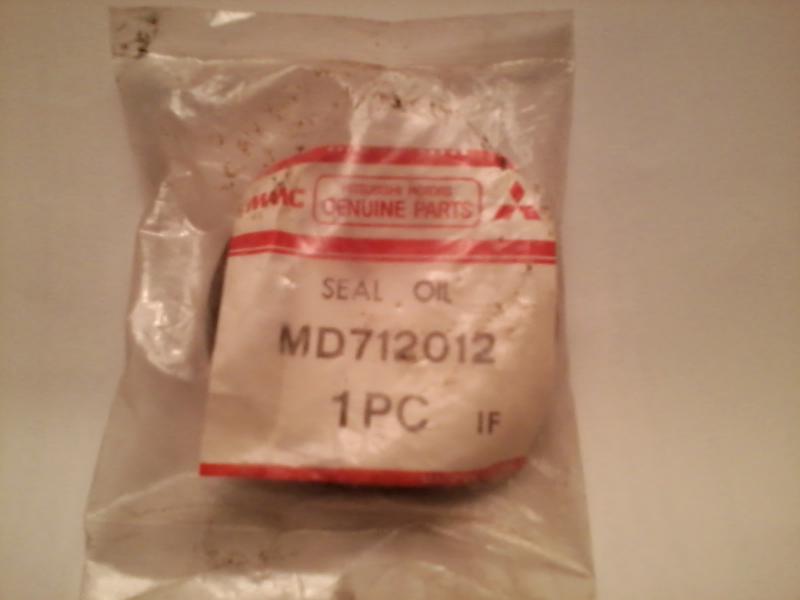

    sounds like you wish to put an oem back in it?:0905142001-02.jpg0905142001-01.jpgMD712012 $15.00 shipped

    Ragtime, you have an oem seal? That's semi impressive. Yeah, I'll take it. I'll paypal you.
