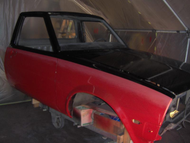

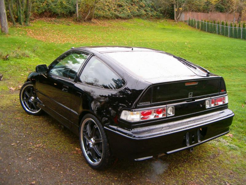

    I used a $69. tool peddler gravity HVLP spray gun. The spray pattern isn't the best
ID:	12645Click image for larger version.

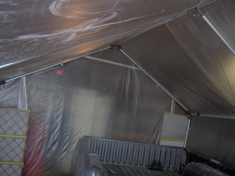

    I use my 12' x 14' x 5ft. wall tent frame
ID:	12647Click image for larger version.

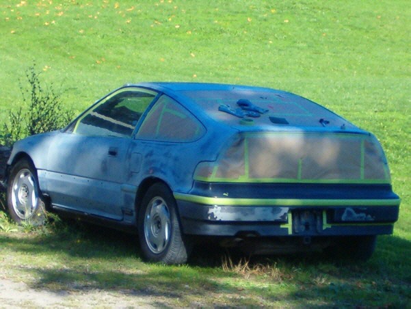

    I use PPG (Ditzler) Acrylic enamel (one step), three coats and I take my time and then I wet color sand.
