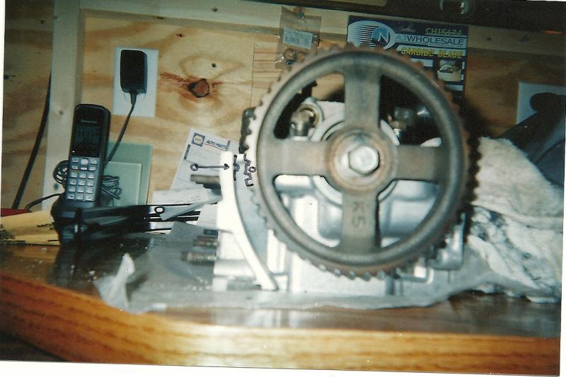

    Not sure about a '94, but for the '90, the timing mark on the head is as follows:
    Making sure #1 is TDC and this mark is lined up, check the crank pulley mark, and the distributor position to assure they're all right on, together.
    Though the teeth might not show wear, it is possible for the engine to slip a tooth or three (as geezer puts it) and this simple test will show you if this has occurred. To slip timing would be rather instantaneous, which could explain a few things. I suspect the surging is the ecu trying to sort things out, but if the timing's off, there's no way it can succeed.
    This is assuming yours' is a Mitsubishi: your array says "other" in regards to engine.
