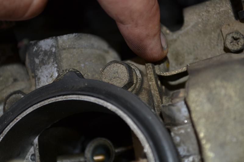

    In this picture it displays the MAS (mixture adjust screw). The plug is already removed. I tried adjusting 1/8th turn by turn until I got the highest rpm. I don't know if this is right but I basically just tried to tweak it until rpm peaked.
    Now my idle was at 1100. But all the while it was smooth as can be, not missing a beat.
    According to a couple other write-ups and alldata the SAS-1 from diagram is the one I turn to adjust idle rpm. Well I tried turning 360 degrees both in and out- nothing.
    So I tried to put it back where it was. Next I moved on to SAS-2 and SAS-3 from diagram. I turned both in and then out 360 degrees (seperately) made no difference.
    I thought maybe the throttle cable was too tight or the kickdown rod for trans. I checked, they are not the ones holding IDLE high.
    Last after looking for awhile I found this screw
    It doesn't seem to be located on the diagram, or maybe I don't interpret it right. The screw is located below the choke linkage and behind the choke tamper cover. But sure enough it lowered the idle to 850rpm is where I left it.
    The truck is still idling smooth but I am not sure if what I did is correct as far as the other screws or proper adjustment. If any one can offer some suggestions. I believe the truck was originally running too lean, previous plugs were white. I am pretty savvy with cars but carb is just before my time. I am trying to learn though.

    Ok here is the breakdown of Choke issue I was having and the solution:
    DSC_4391.jpgSo everything was working, except the choke closing too much at first start up flooding it. So this piece of wire was used to shim out plate. It would run perfect with this plate, but is "shade tree". Taking it on advice from some wise members I decided to remove choke access plate and adjust the gear for the choke a few teeth.
    DSC_4392.jpgDSC_4393.jpgDSC_4394.jpgto get this plate off you have to grind off rivets and then unscrew 3 screws but the heads have been ground off for security.
    DSC_4395.jpgI taped up the carb to prevent things from flying in there while I was using the dremel to cut off the plate. I did this entire thing on the vehicle.
    DSC_4400.jpgAfter grinding the 2 rivets I used a cut wheel to put a notch back in the 3 screws and then used a screwdriver to remove cover.
    DSC_4396.jpgDSC_4397.jpgDSC_4398.jpgThis is the choke mechanism before I tried to adjust.
    DSC_4401.jpgDSC_4404.jpgIn this picture you can see 2 brass screws that hold the choke adjusting gear and plate to the carb. They are 8mm is size. If you loosen these you can pull the plastic gear out and spin it to tighten or loosen the force of the choke plate against air horn. In my case I needed to loosen 2 teeth. The top screw has a slot so once in place you can fine tune adjust the choke plate. *****The bottom screw hole of the plate sits on a extruding stud, to prevent sliding. I snapped the head off my screw like a dumbas*!!!!!!!!!!!!!!
    DSC_4405.jpgReassembled and the perfect choke clearance was there. Started truck, ran perfect, came to operating temp, High idle is good and drops to 750rpm. Everything is great! just that broken screw. I dont think that plate is coming off but the only way to get a screw extractor in there is to pull the carb!!!!! I dont want to but lets see how it goes. sometimes I get a wild hair..
    Thanks for everyone's help!!!! Do you think the other screw Is enough to hold the choke adjuster plate on or should I try to get the broke piece out?????
