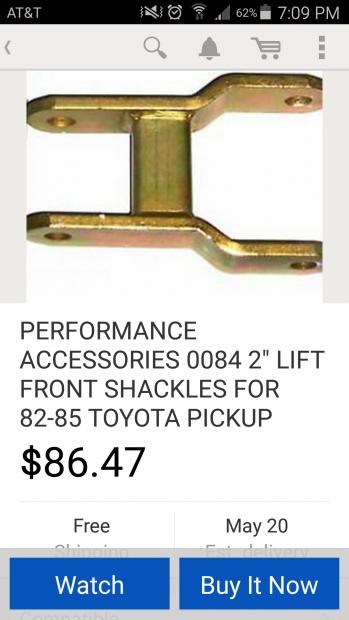

    Rather than an add-a-leaf, consider a Toyota lift shackle from Conferr or Summit. The item you need would be an extended shackle intended for the front springs on 79-85 Toyota pickups or FJ-series for the similar era.

    This is just the thread I was looking for. I know it was a long time ago but I am getting ready to order all kinds of parts and was wondering if anyone knows what lift shackles for the rear I would need. Would this work or not?
