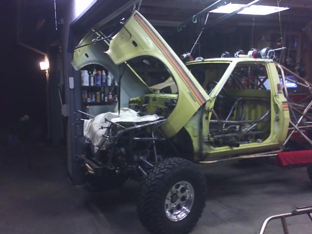

    Well the cab is now cleaned up and ready to start on the fabrication. I found a nice sharp air hammer bit trimmed the cab real easy. I just took my time and worked on the inside of a bend next to the line of spot welds or with a steel backer and she cut like butter. I cut out the inside of the doors in order to give my self 4 more inches of elbowroom in the cab. Once the roll cage gets started things get tight quick. I will start with the doors by using some square and round tubing to re-enforce the door skin. The whole cab can be picked up one person now. I would guess it’s around 185Lbs. I’ll try to get a weight on it before to long. Building the front suspension is going to be a little harder then I thought, due to the narrow with of the truck. I might be forced to widen and lengthen the wheelbase in order to accommodate the new suspensions. The doors are made stable again. I used 1 inch round tubing across the top of the door panels. Tacked it to the tubing across the top, then used ¾ inch square across the bottom of the door just under the door latch to the lower hinge mount. Added in ½ inch square tube between the two. I found that the ½ inch square fits nicely in the stock window channel. It makes it easy to weld to the back of the door just above the door latch. Just gives enough room to remove the latch. Once the roll cage is installed I will be able to put the inside door handle back in.

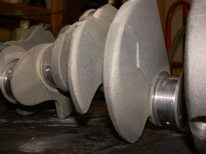

    Well I picked up the crank from the machine shop today. It was tanked and checked for cranks. It looks to be stock. I brought it home and DE-burred it tonight. It took about 2 hours. It’s not a 32 Lbs crank but it is cleaner then just a cast. The machine shop has another 4.3L V6 there right now. It came out of a bush grand national car. The guy that owns it paid $18000.00 for the engine used. I’ll snap some pictures of it. It’s an odd fire unit. The estimate of the rebuild that they are doing sits at $14000.00. It will make 500 Hp when they are done with it. Here are some before and after pictures of my crank, along with a side by side of a stock crank.

    So now it’s time to work on the crank. They will polish it if possible,
    if you had spun a bearing or lost oil pressure they must grind down the bad journal.
    Now it can be rechecked for journal run out.
    Last but not least of the fun stuff is the spin balance. In this step we must know a couple of things. First is the weight of connecting rod. This is combined with the weight of the piston and the rings. To simulate the pistons and connecting rods you clamp on these adjustable weights.
    Now we can spin it up to speed.
    During this test we can find out where the heavy spots are. There is a meter on the balancer that shows witch end of the crank is heavy and how high from center is the heavy spot. There is a strobe light that flashes on the crank so you can reference the crank to find the heavy spot to drill.

    I started burning wire tonight. The 2 X 4 box tubing is squared and tacked to the Extera front end. The roll cage will go fast.

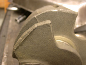

    My crank was balanced today. Or I should say they started on it today. I just happened to show up there when Mike, the crank and head guy was working on it. He was having a problem with the balance. He was trying to figure out why the balance was so far off. Apparently the 4.3 V6 even fire engines have a built in unbalance to them. The odd fire is not as bad. The crank is a total of 180 Grams under weight. 180 Grams under is nearly un heard of. But then again this is a Chevy V6. There known as the little shaker. They did not have the right weights to finish the balance. They need to order them in. 5 days. One weight is in LA and the other they need is in Minnesota. I can’t figure out for the life of me why GM or any other manufacture would have an engine so out of balance that they need to have a counter shaft. If they would just balance the engine to begin with they would not need the horsepower robbing balance shaft. But I can only guess that it must be cheaper for the manufacture to just drop in the shaft and keep production rates high VS spending the extra time to do the job right the first time.
    If you look at the picture you can see the added weight simulators on the left and right of the crank. It’s a bolt with a copper weight on it locked between big counter weights.

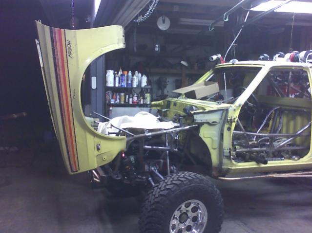

    Now it was time to place the engine and center the body on the frame. But how do you figure where to place the body in relation to the “A” arm mounts, or even the engine and trany? Where or how do you start? Well here is what I did. First I would need to find the centerline of the front spindles. To do this I placed the upper “A” arms in the frame then ran a string between the two. I then marked the frame with a pen then used a peace of tape and used silver paint to make a permanent mark. You can see it in the picture below.
    Now I can measure back from that line, the distance from the spindle to the cab on my other truck and apply this to the new build. From there I dropped in the engine and trany. Once I found the sweet spot for the shifter I raised it up to its final height in relation to the cab. Keep in mind that the cab must be raised off the frame rails. After securing the engine and trans with a jack stand and floor jack we lifted the cab back off. Now I centered the engine and trans to the frame. It came out with in 1/16 of an inch after building.

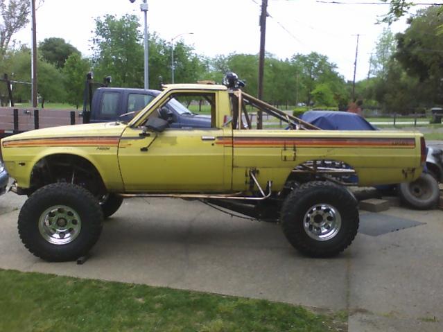

    Now here I lifted the truck up to the ride height. It sits at 24 inches.

    The Question?
    Now here is a question for you. How should I make my hood open up. Keep in mind that it will be a one peace fiberglass hood. I'm sending it out to the body guys ASAP.
    It will not look the same as what you see here. It will be totally different when finished. This will give me an idea on how accessible it will be. I love the look of the front tilt but then it's a pain to get to the front of the engine to change a belt. So I'm leaning toward the rear tilt. The rear tilt will have 1/8 fenders only attaching to the cab area.

    man that is some really nice work. i dont even know what to say.
    glad to see it come this far. have the fornt tilt back....its alot easier to access... a few buddy's have dont this on there bronce 2 and few boggers they have.
    I say make it pop up like the jeeps but more stable connections. Also detatchable hinges. So it can come off completely. Tilt for easy access and removable for convinience.
    674
    Stafford, VA
    Quote Originally Posted by 4doorciv View Post
    yeah that is very common on some boggers i have seen....looks awesome too...
    I keep having to take off the hood to work on my truck. It's so much easier to work on it without the hood or the hood prop in the way.
    04-01-2011
    155
    Garden Valley, CA
    are they gonna be bulged fiberglass fenders? if so how much of a bulge is there gonna be?
    If it's fiberglass? Carriage pins and fast complete removal. Ditch the tilt. OR, do the carriage pins thing with hinges to the rear. That gives you a choice - tip it or pull it. Fast either way and easy to fab.
    I like this idea. ^^^^^ You watch a lot of dakar rcing?
