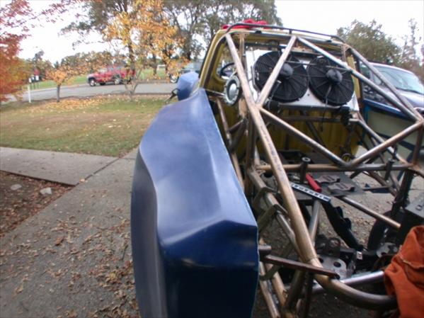

    Time to mount the body.
    On the rear bedsides I had to work around the nurf bars that are in front of the rear tires. (This is to keep the Honda cars away from the rear tires) I used a fiberglass splash to make the necessary cuts. Then used the splash as a pattern and transferred it to the bedside for the final cuts.
    Next comes the hard point mounting. I’m going to use an aircraft cam-lock to hold on the body parts.
    Here are some pictures of the body after some of the hard mounts are built.
