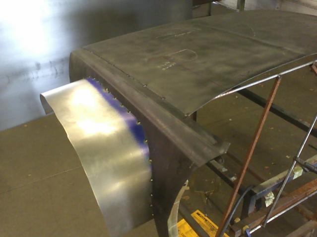

    Body construction has begun.
    The bodywork is under way.
    The first step was to set the body on the truck and look at what was going to look the best for the overall project.
    First I marked up the fenders with my ideas of how things should fit and look.
    Then I dropped off the body to the masters of bodywork.
    Ben is the man that is working as my sculptor. He normally does high detail, dental work for bodywork. He is also an off road guy at hart.
    He has wanted to build a truck like mine for years, so he was extremely excited to get the chance to sculpt out the body and pound out some fenders.
    He was going to build everything out of sheet metal, but that turned into a problem.
    The extreme angles needed to make the body look right made the use of all metal nearly impossible.
    So he is going to be using a mix of sheet metal and expanding hard foam to build the fiberglass mold.
    The first thing I had them do was shorten the bedsides by 1 foot off the rear, no need for long bedsides.
    From there they have a free license to make the front end look correct.
    The front end will be widened by 20 inches with tire bumps and flairs. There will be a cowl induction hood designee built into it for clearance of the air intake system. The hood and fenders are going to be a 1-peace designee, with some small fenders, or splash grads. I will update things as we go.

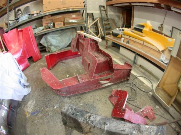

    I found a fiberglass guy that was willing to work with me. This guy has a crap load of body molds. Corvette, GT, Formula 1, Pro Stock, you name it. He has Formula 1 McClaren molds from McClaren them selves, from there first car, to the car of tomorrow (Shhhh). They are sending him the plywood shapes. Once I get a picture of it then you will see how to do a mold the right way. All I could say was Holey crap. It's nothing like you think..
    A Formula 1 wing,,, just the wing, not the mounting or anything will run you around $12000.00 just for 1 part. The process will be detailed later on in the build. It involves a Auto Clave type thing, and some large press type equipment.

    Lets dive into the world of composite bodies. The man I found to build the body has been building composite bodies for years.
    Jeff currently has all but 3 F1 McClaren molds from the McClaren factory. He is expecting a prototype mold to arrive soon. I’ll get some pictures when it comes in. His main focus is in racing from the F1 to the GT car bodies.
    The first thing was to shorten the rear bedsides by 12 inches off the back end and build an under structure. Next was to cut the wheel opening to match the front.
    The front fenders and hood was welded together and a full under structure was built to hold the form of the stock shape. Next was to cover the whole thing with 10Lb foam. Then rough cut and sand to shape.
    When building the plug, it is important to avoid sharp edges. If the plug has sharp edges then you may have problems with the first covering of fiberglass when making the hard shell. If the edges are to sharp then the glass can bunch up and not lay flat where you want it.
    Next is to fill the large air pockets on the foam with some bondo. This will reduce the possibility of the mold generating air pockets from heat.
    I plan on having louvers in the hood. They will be cut into the part after it is built. It’s easier to cut them in later because they take so much time. When working with the resin and fabric you need to keep things moving and not stop.
    The louver plugs are from a Chevy Camaro.
    Next up will be the building of the mold and the final body work.

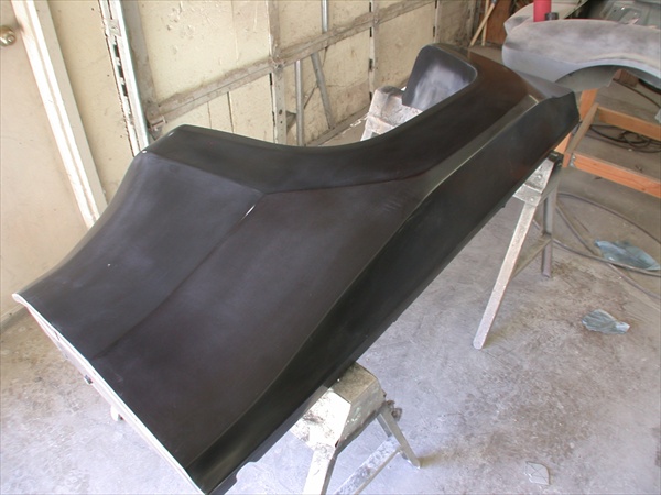

    Building the class A mold and plug.
    Willie has finished the bodywork on the rear bedsides.
    After the hard shell was placed on the foam it was covered with a black 2-part feather fill primer.
    This makes it possible to see all the imperfections of the hard shell.
    Next comes a skim coat of Bondo.
    The Bondo was applied and worked in sections. This is done so the lines of the body are not lost.
    Now the Bondo is rough sanded down so the hard shell and black just shows through the Bondo.
    Now the lines can be squared up using masking tape.
    The tape makes a nice straight line. You sand the curves out until you just hit the tape.
    After the body is fully sanded another coat of gray primer is placed on the plug, blocked and wet sanded to get the final body lines. Then one more coat of the black 2-part feather fill primer is applied. Once cured the primer is buffed smooth to a glass finish. The smother the finish the better the part will come out.
    This is referred to as a class A plug and mold. Next the plug is prepped for the mold. The first thing is to put on a good coat of Partall Paste #2 Release wax on the plug. Do Not Use a carnuba wax, you are asking for trouble. It can’t take the heat that is generated by the resin. It can reach temperatures of 130 degrees. Next you can tape on card stock paper flanges to the plug. The flanges will make it possible to remove the mold from the part and give the mold a back flange that gives the part it’s strength. The last step before the fiberglass is a thick coating of tooling gel. Tooling gel is a harder gel coat then what is used for the part. Once the fiberglass is applied to the plug it will bond to the gel coat. After removed from the plug it will be absolutely smooth just like the plug was. Next comes the building of the part itself.

    Now you can apply the first the resin coat over the gel coat. Work in small areas so you can keep the areas wet. If you take too long on one area then you run the risk of the resin drying on you. Work fast you have about 45 minutes if the air tempters under 65 deg. Now you can stick on the first layer of mating.
    Then cover it with more resin pushing the mating down around the corners and edges. It’s best to have 2 people if working large parts. One person applying the resin and matting while the other works the roller removing air bubbles and working the matting into the corners.
    Overlap the matting about 1 inch. It should overlap like shuffling a deck of cards. Once you have worked back to the peace you started with you can start the application of the second layer of matting. Then more resin, and more rolling. Once you have covered and rolled the whole area including the flanges with the 2 layers of matting you can now apply 2 layers of cloth. It will be the same process but you should not need as much resin. Remember be careful when rolling not to pull the material. The cloth should not need as many relief cuts if any. It is more flexible and now the sharp corners are covered the whole thing is thicker and flatter. Work fast keeping things moving forward. The 2 layers of cloth go right down just as soon as you have covered the area with the matting. No stopping, no breaks, just go, go, go.
    Now you can have a beer because you are done for a couple of days. Let it out gas for at least 48 hours before removing the paper flanging you made. In the mean time you can start to make the last set of flanges for the “Lock Up” areas. After removing the paper be sure to wax the new fiberglass flange areas. Otherwise the mold will never come apart. This will be covered in step 3 and 4 later on.
