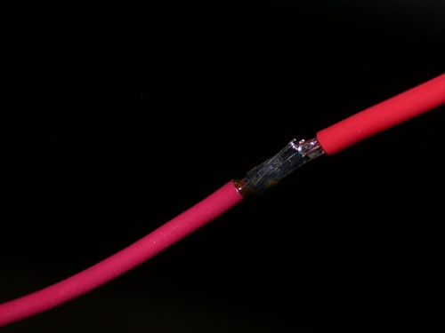

    I started working on the electrical system. I’m doing things the old fashion way. With no solder less connectors. All splices and ends are solder are heat shrink sealed.
    The only connectors used are the water tight and fully sealed GM style. They are a 3-peace type connector.
    The fuse panel is out of a Freightliner truck. It has circuit breakers not fuses. This way if there is a problem then the power can be restored automatically with out the use of a fuse.

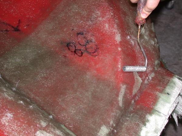

    The very first and most important thing is to wax everything. And I mean everything including the paper you will use for the flang of the mold. Use the correct wax Partall Paste #2 Release Wax is the recommended wax. Then over the top of that you apply a coating Partall #10 Release PVA Film.
    Next is to mark and cut the flange paper. It’s a good quality smooth card stock. You can get it for free if you hit up the local print shops around town. They normally just toss out the scraps, so it’s in your favor to ask them about getting the leftovers. Mark the paper with a marker and cut to fit. Make the fit as tight as you can.
    Things to look for when determining how and where to put a flange. The first thing is to look for is what is called a “Lock Up” This is a place the where the plug turns back on it’s self. Take a look at the front fender of your truck. The lock up area starts near the bottom. If you were to just cover the hole thing with glass and resin the plug would never come out of the mold, so you make a flange near that area out of the card stock. Keep in mind you want the plug to come out of the mold as easy as it can.
    Once you have the plug flanged completely it is now ready for the tooling gel coat. You can spray or brush it on; it’s up to you. Cover only the plug and flanges within the first area you plan to work. This is the area before the lock up. Allow the tooling gel coat to dry over night.
    NOTE; Pre fit everything.
    Now you can start the fiberglass lay out.
    Look out for tight areas where material can bunch up. Make as many relief cuts as necessary to allow the fiberglass to lie down on the plug and go over sharp bends and around corners.
    Use as large of a peace of glass as necessary to cover an area. Don’t try to cover the whole thing in one try. This would cause the material to pull away from the areas you have already covered earlier. The stranded fiberglass mat is not as flexible as the glass cloth you will use later on. The mold will get a total of 4 layers of fiberglass, 2 of the multi directional mat and 2 layers of cloth.
    Now you can apply the first the resin coat over the gel coat. Work in small areas so you can keep the areas wet. If you take too long on one area then you run the risk of the resin drying on you. Work fast you have about 45 minutes if the air tempters under 65 deg. Now you can stick on the first layer of mating.
    Then cover it with more resin pushing the mating down around the corners and edges. It’s best to have 2 people if working large parts. One person applying the resin and matting while the other works the roller removing air bubbles and working the matting into the corners.
    Overlap the matting about 1 inch. It should overlap like shuffling a deck of cards. Once you have worked back to the peace you started with you can start the application of the second layer of matting. Then more resin, and more rolling. Once you have covered and rolled the whole area including the flanges with the 2 layers of matting you can now apply 2 layers of cloth. It will be the same process but you should not need as much resin. Remember be careful when rolling not to pull the material. The cloth should not need as many relief cuts if any. It is more flexible and now the sharp corners are covered the whole thing is thicker and flatter. Work fast keeping things moving forward. The 2 layers of cloth go right down just as soon as you have covered the area with the matting. No stopping, no breaks, just go, go, go.
    Now you can have a beer because you are done for a couple of days. Let it out gas for at least 48 hours before removing the paper flanging you made. In the mean time you can start to make the last set of flanges for the “Lock Up” areas. After removing the paper be sure to wax the new fiberglass flange areas. Otherwise the mold will never come apart. This will be covered in step 3 and 4 later on.
