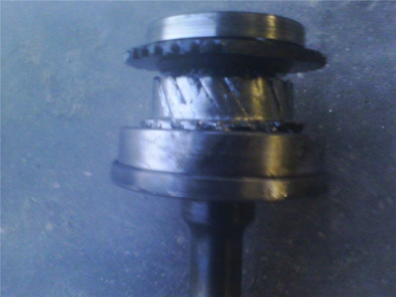

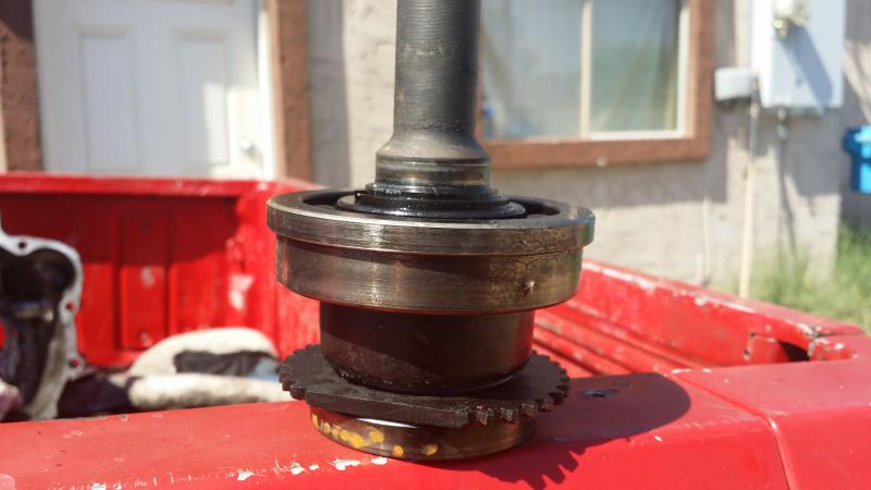

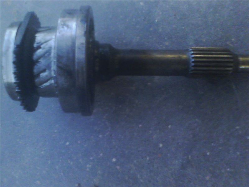

    Got it figure out Camoit and thank you very much for posting those manuals.. I did get my transmission MOSTLY apart. I am having a heck of a time with the bearing race to the rear main shaft bearing, cant seem to get it off. Anyway I found my problem. My input shaft is shot. Suprisingly my idle shaft doesnt look bad at all. The gear on the idle shaft that meshes with the input shaft doesnt look perfect but no broken teeth or nothing.
    If anybody knows a trick to getting this race to the rear main shaft bearing I would sure like to hear it..lol
    Oooooh, that is nasty dude. I think the bearing needs to be heated while in a hydraulic press so the shaft will push through. Might be better off finding another gearbox with a blown gear and tear it down for parts.

    . The pic is of input shaft. It will need a different shaft for sure. May have found my first parts truck. 83 4x4 with a diesel... Im pretty sure the transmission is the same and it is supposeable good I guess the Diesel engine is tired and dont start right. Would store it for later maybe... I would also get 2 good front feneders and what I would need to fix the other rust spots. Not sure I will get it though as the owner isnt for sure he wants to sell.. If I do get it I will be sure to post and to see if someone else needs something off of it.
    the internals of the tranny are the same, but the bell housing is not. 2wd 5spd trannies are all the same for truck 2.6 and starquests - later starquest trannies have stronger shafts and bearings forthepower of the turbo motors.
