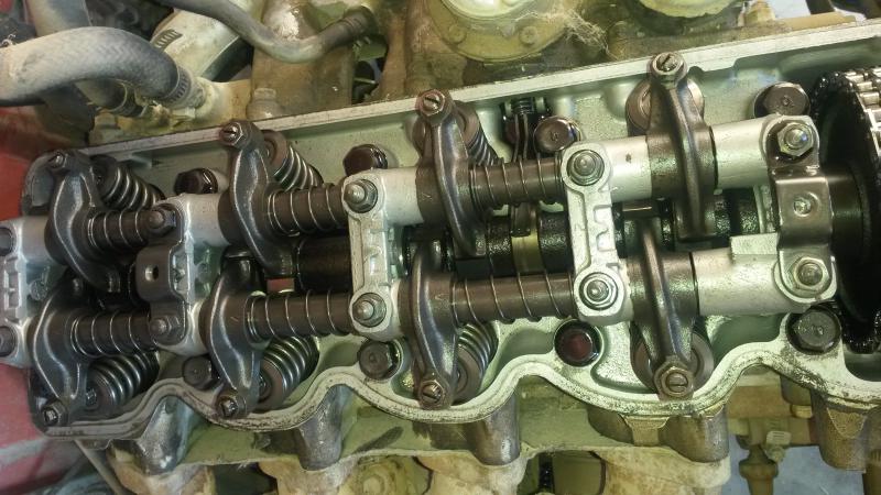

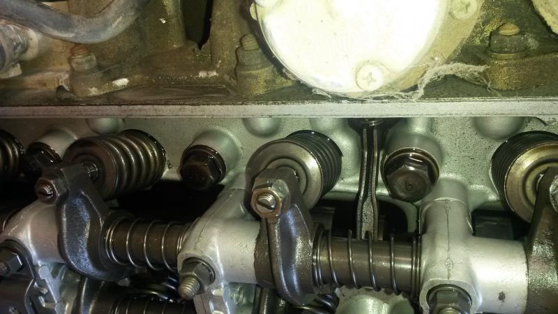

    I have an 84 D50, 2.0 4 speed. I bought it not running and just pulled the valve cover. The head is very obviously newer than the motor/truck. I've worked on these before and I've seen both operable valve jets, and I've seen the plugs in place of the Jets. On this one, it has neither, and the cam rocker doesn't even have the extension you see coming off to run the valve jets. Has anyone experienced this before?

    Haha thanks for the info Brad. And yeah, I'll get some pictures up. The bypass plugs haven't been installed, the head is simply made without the jet valves, to my pleasant surprise.

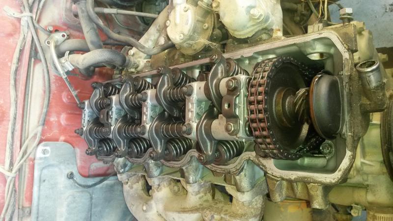

    There's the pictures of the head with the valve cover off. Simply no jet valves.
    1,267
    I'm no expert, but I think that's a 2.6, not a 2.0. I only say that because of the timing chain instead of a belt.
    Whatever it is, it sure is clean!
    My G63B is a non-jet valve head. It appears that the MCA-JET valves were not a mandatory introduction to Mitsubishi engines sold here in Australia. I am having a hard time finding one that isn't hydraulic though!

    yup yup that is deff from the astron family. either 2.0 or 2.6 not my engine flavor thou
    2nd that being an astron motor, so a non jet head is definately available for it. And from the looks of the fitting on the front of the head, it is a 79 - 82 setup, possibly a caravan head which were non jet valve heads.
