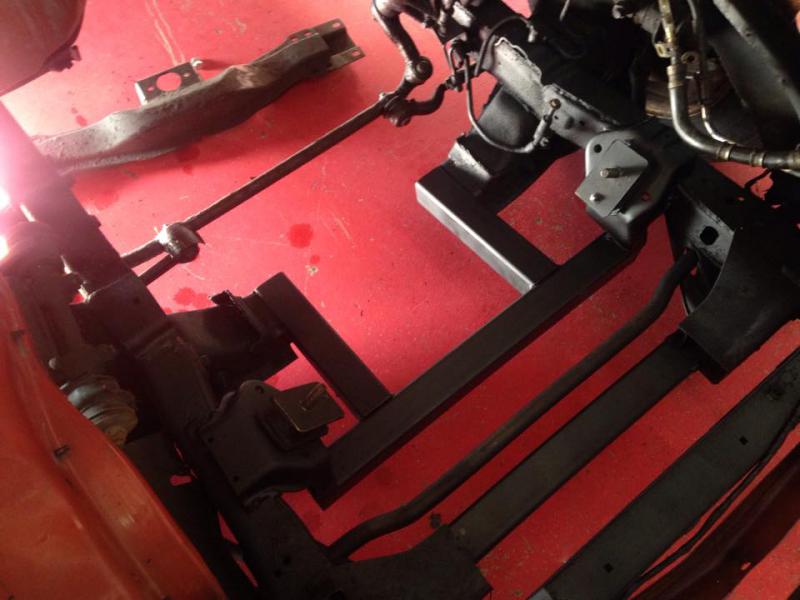

    Engine is back out so I can finish welding everything

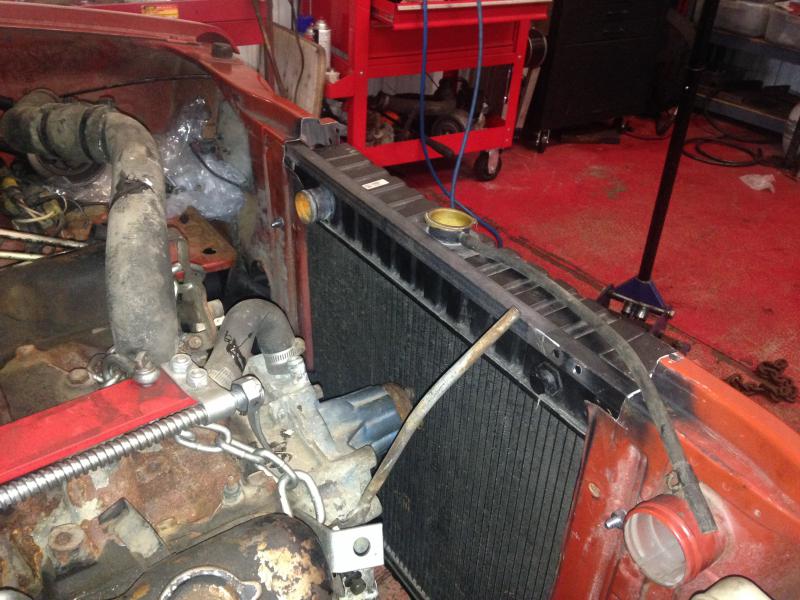

    Does anybody know what's been done with radiators or water pumps for this conversion?

    It looks pretty BA! Doesn't really show me the radiator tho. I'm going to try using the one from my d100 tomorrow! I gave in and got hood pins... I really wanted to keep the outside stock/beater looking :p

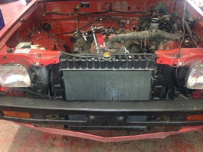

    I got a radiator that fits and I got it mounted in! Does it look like its got a 360 settin in it?

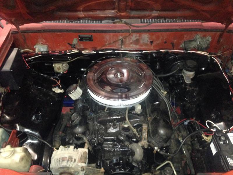

    98% of the wiring is done! It cranks but I need to hook up an ignition relay and finish hooking everything else up

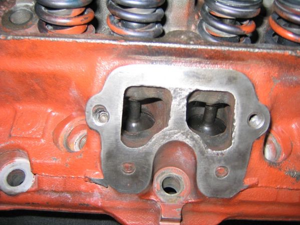

    Anybody know what size the holes are for the egr/pollution ports? I'm going to be using different manifolds or headers and I'll need to plug the holes. I keep forgetting to measure them while I'm at work.
